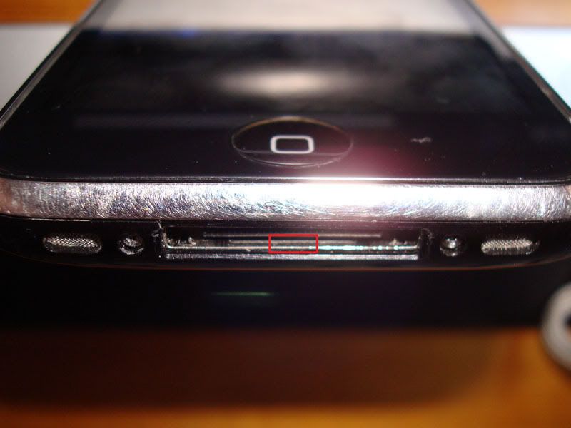

I've heard people speak of the water sensors on the iPhone, and I'm beginning to worry that I may have dropped it in my pint or something stupid like that - are the 'green lights' visible when it's water damaged?
There are no water sensors in the electrical sense but Apple have markers on the phone that turn pink if water has been inside the phone. When they come to repair it they can check them and it won't be covered under warranty if they have been triggered. In regards to the 'green lights' being visible, who knows? Water damage can cause any number of components to fail.

In answer to the water indicators on a 3GS there are 4.
One at the bottom of the headphone jack, one in the dock connector under the protruding pins in the small gap between the non metallic side of the pins and the dock interior there is a small cutout square showing it.
The other two are under the LCD assembly.
The indicators are white when unaffected and pink/red/blackened when water has been an issue.

I've had a look at the indicator in the headphone socket, and there is a tiny little speck of red, but the majority of the indicator is white. Surely that could be just brought about by me blowing down the headphone socket to remove dust?
Can't say I can see that other indicator in the dock connector, however :confused:

The one in the dock connector is hard to see, you need an unused paint brush or something similar to brush any dust out of it first and then shine a torch into it, it's under the bottom contacts in a cut-out square. Once you know where it is it's easy to see. mine is bright white on both the dock connector and headphone socket.
