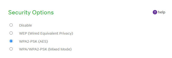

This is how the router setting looks now:
They are both on WPA2-PSK (AES).

The 5Ghz is on WPA/WPA2-PSK (Mixed Mode) and the 2.4Ghz is on WPA2-PSK (AES)? Should I switch them so they are both on the same Security option?
Mismatched security is only normally an issue when you have 2.4Ghz and 5Ghz both are on the same SSID
As above - it shouldn't matter as you are operating them as separate SSIDs with different names.

Okay, so all of a sudden, I seem to have cracked it and got it working. I changed the security settings to WPA/WPA2-PSK (Mixed Mode) on both the 2.4 and 5GHz settings.
To me, within my settings it also looks like although the 5 and 2.4 GHz bands were available, they were both sharing the same SSID. So I ensured that they were not synchronised and then gave them both individual SSID's. Went into network settings on the iphone, my ipads and also my laptops and 'forgot' the old/previous connections/SSID's.
Lo and behold, it now connects instantly to the 2.4GHz and the 5GHz.
Would it simply be the case that giving the two bands different SSID names has done the trick? The only thing I do notice is now in the iPhone and iPad network settings it is saying 'Weak Security'? :confused:

I think because now you have given the devices the choice to use WPA or WPA2 is why it is working, the low security warning is probably because they are using the WPA side of it rather than the WPA2 which is more secure and WPA3 being even more secure.
