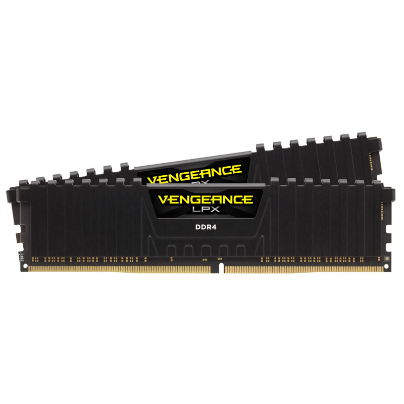

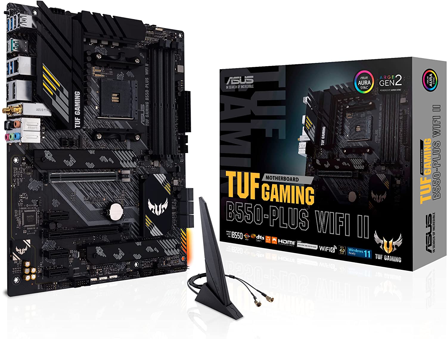

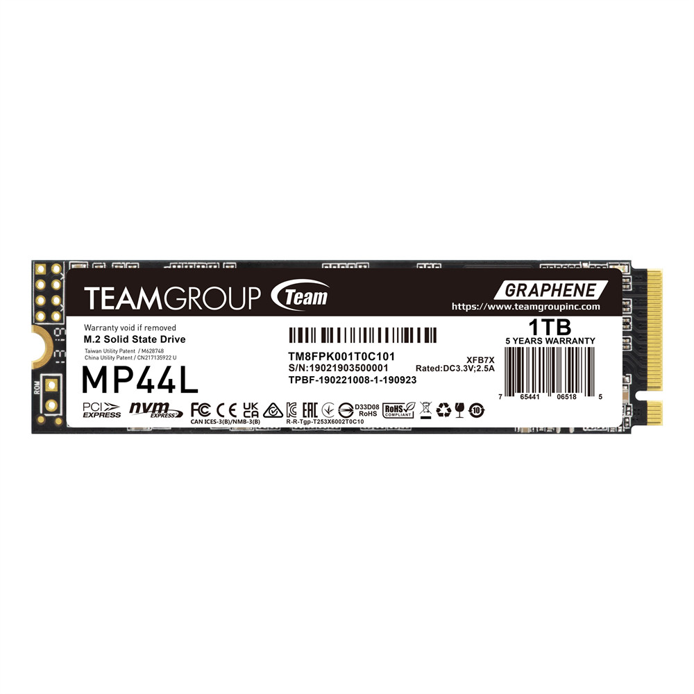

My basket at OcUK:
Total: £1,017.92 (includes delivery: £0.00)​
below he explains a bit about cpu/gpu pairing..5700x3d more than enough for the gpu...gpu will be the limiting factor..as the monitor is superwide, it's pushing a lot of pixels, so you can compare it to a 2 1440p screen side by side. the 7800xt is slightly slower than the 6900xt(previous gen but level up), but fairly close and the 6900xt is pushing 3 1440p screens so being worked harder..so hopefully you'll get something similar in performance by the end
below is relative performance and you can see the 6900xt is 3% faster than the 7800xt, so not much in it, and the 7800xt will only be pushing the equivalent of 2 1440p screens, not 3 as in the vid below
so below is a 6900xt and 5800x3d pushing 3 x 1440p screns sim racing. 5800x3d is slightly faster cpu than the 5700x3d, but not much in it at 4k, and it's out of stock as production finished and generally another £100...so not worth it
