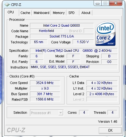

Nope, I run the above 24/7 folding away like a mutha licker.... not a problem

you needed 1.32v to get your b3 to 2.7 ? Maybe im just lucky to get my b3 to 9x333 at 1.275 around 40ish full load
