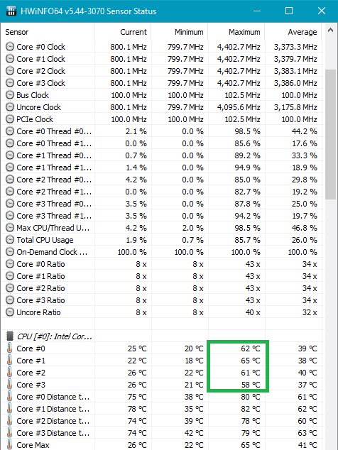

It's normal. Which isn't to say it can get as hot as it likes. If you want to know whether the temps are fine, post your system spec (including case, CPU, CPU cooler and GPU), and install a program that can monitor temps like HWiNFO64. The latter will allow you to see the maximum temps reached after gaming a few hours.

Yeh leave hwmonitor running whilst playing to see what peak temperatures you are reaching.
As long as it's not getting too hot, it's perfectly normal.
Anything under 80C is fine for extended use in most cases. If you're seeing temps over that then you may want to look at better cooling. But yeah it's normal for it to heat up and fans to spin up louder as gaming will ramp the components up to full speed and utilisation.
