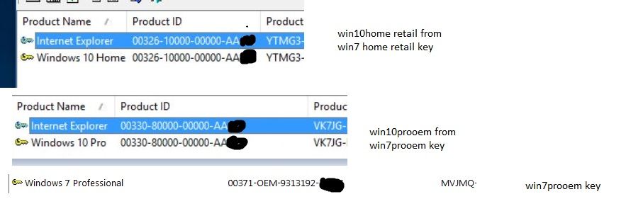

ITtroll, thanks,
below are some screen captures of the product Id's and keys captured with produkey on the same hardware/system with a 3way multi-boot
- a win 10 home retail install, for which I supplied a (different) win7 home retail key
- a win 10 pro oem install , supplying the win 7 pro oem key
- original win7 pro oem boot license
so these each have a different product ID, different to the ID's you gave,
but maybe that is because I supplied the respective 7 keys to the win10 boots to authorize them (as opposed to automatic authorization)
I theorize these 10 product keys are the digital entitlement keys (which I can note down, for any catastrophe that might occur; but have not yet proven that by using them in a fresh install)
( Maybe produkey does not work under win 10, it was working under win7 though and product key concurred with the COEM on the laptop and I have used it already for a re-install.)
so what do you think the significance of these 10 keys are ?
I have only shown the first few characters of Product key column since I think these keys are unique to me, and although I think the ID's maybe shared, have blanked a few digits.
(maybe authorizing using 7 pro/home keys is a more robust strategy as I now have a key noted down, unlike the ethereal digital entitlement)

They look like the generic keys to me. The second one appears to be using the VK7JG key. The first one appears to be using another well known generic key; YTMG3-N6DKC-DKB77-7M9GH-8HVX7
The third one is a unique OEM key.
The Product ID is standard to all and just identifies the edition retail/OEM/home/pro etc.
ITTroll thanks,
yes, my error, when I googled the product keys I had, more extensively, I found they were indeed generic keys.
I am still unclear whether a 7 retail key freely upgraded to 10 retains some retail portability versus an oem upgrade, in terms of being able to susbequently re-activate if you change hardware;
since, if you can change hardware, that would have seemed a reason for a non-generic key being delivered. (articles like this lead to my error)
