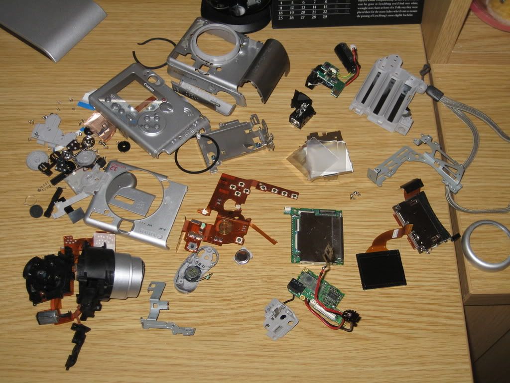

typical, I have an A70 that did this about a year ago. Only last Friday curiousity got the better of me and I dismantled it to see if it was anything obvious. There wasn't and now I have a camera in about 500 bits! :)
Shame you didn't see this thread first! You could have got a free repair too :(
The repair company apparently replaced the CCD unit on my camera.
