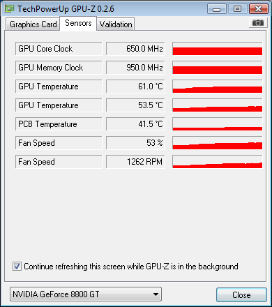

Ati tool shows no artifacts after 10 mins which makes me wonder if they would accept it as an rma.
< full load
