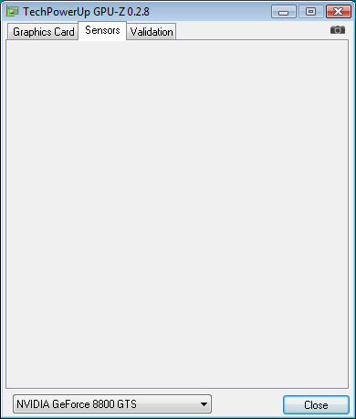

that does not sound much different from mine..
