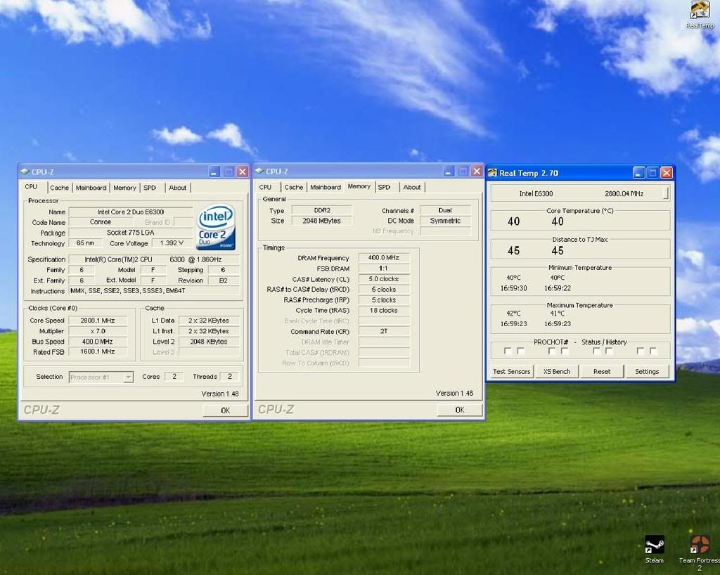

Trying to overclock but when I get above 2.5Ghz it crashes or freezes when I run Blend in prime 95, but perfoms fine in place large FFts. In fact in large FFt's I can get over 2.8Ghz. Even at 2.8 cpu only hits 58C at full load
does this mean I have a memory error?
E6300
Asus p5k-e
2GB OCZ 6400
What appears to be stable although need to run a longer test
FSB - 355
Cpu Voltage - 1.3500
Divider - 7
Ram 2.05 (max 2.1)
Is that the maximum i can get? is the ram holding me back, is there some other settings I can try.

your fsb dram isnt running 1:1, try running at fsb 1800 and ram divider at 2 - this will give you 800mhz dram.
edit - what cooler have you got, thats pretty high temps...
yeah change your divider on the ram down to 1:1 that should net you a lot more room to overclock the cpu
as stated, had to pull it back from 3.22ghz to work out what has gone wrong!
edit: added new image
Thanks guys seem to have it stable at 3ghz and don't want the temps any higher.
think I would need ram and better cooling to go faster.
Although do you have any idea how to stop it dropping the multiplyer? I assuming it's speed stepping or an asus version of the same thing.
yeah c1e stepping(speed stepping) in your bios, turn it off. plus you could always go higher than 52c, 65-70 is acceptable! ;)
If you look at max temp it's 60 at full load after 12mins..
If I up it to 3.2-3.4 after a while it hits 64C and I get a black screen.
Also i don't think the ram likes it as I can't see a setting to isolate the fsb dram. Which means even 3.2 would mean 450Mhz
