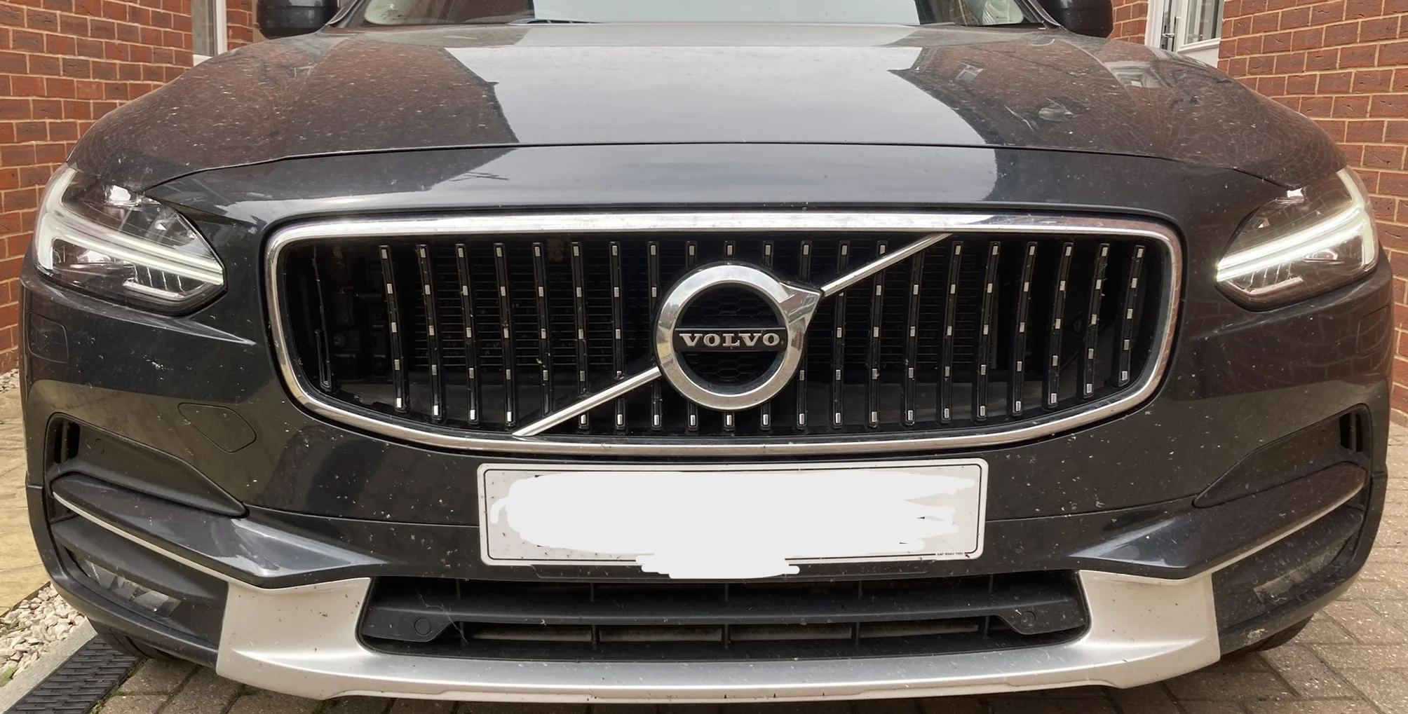

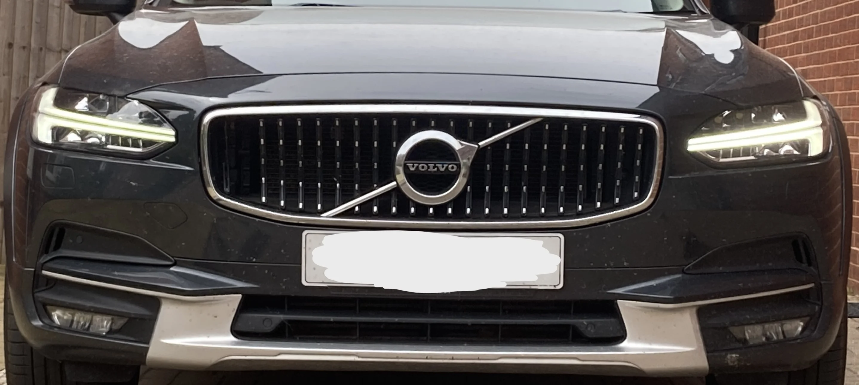

Drivers side DRL on my V90 has partially failed. It runs at about half brightness, which during peak daylight makes it somewhat difficult to determine if it’s on or not. The pictures below show the difference but to the naked eye the difference is greater. Inside a garage or at dusk/night it is visible as on but obviously dimmer than the near side. Do you think this will be an MOT fail? Car was first registered June 2018.
MOT expires tomorrow and Volvo won’t have the headlight unit until next week. It was originally scheduled to be fixed and MOT’d tomorrow but the part was delayed. I’m hoping it’s enough to pass so I don’t have to rent a car until my new one arrives Thursday.
On another note, if it does fail the MOT, will this impact the resale value even though it will be fixed and Retested prior to sale? I’m probably going to flog it through WBAC or Cazoo or similar.
Thanks.

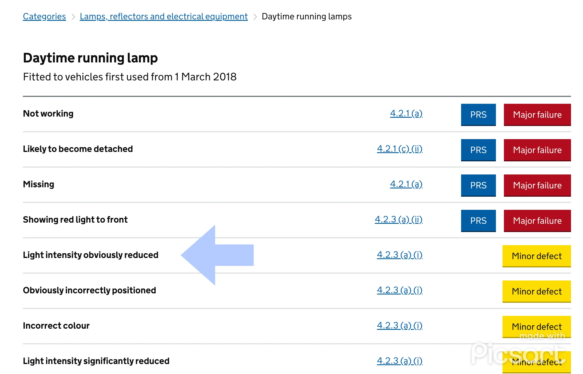

Just read this on Gov.uk... Makes it a little confusing
Daytime running lamps​
You only need to inspect daytime running lamps (DRLs) fitted as original equipment to M1 vehicles first used on or after 1 March 2018.
There must not be more than 2 DRLs fitted and they must emit white light.
DRLs might not operate when:
  • the engine is not running
  • the parking brake is on
  • the park position is selected on automatic vehicles
If DRLs have been manually switched off, sometimes they do not light up until the vehicle is travelling faster than 10km/h (6.2mph) or the vehicle has travelled 100m (328ft).
A DRL is permitted to switch off when the same side indicator is operating.

That will most likely fail the MOT, I certainly would fail it anyway.
My bad, it would be a minor defect but not a failure. Blaming tiredness for that one!
What i meant to say was i can turn my DRL's off and pass an MOT. The newer cars have to have them on.
