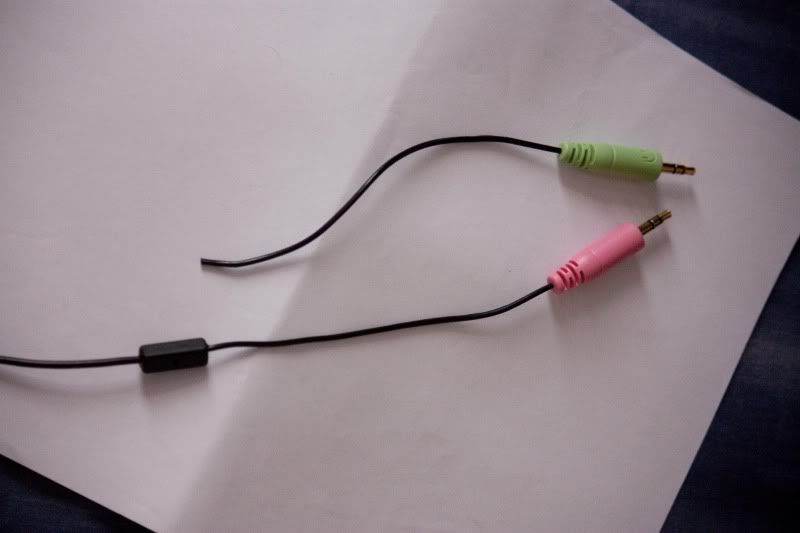

So i came back home today and found my Creative Fatal1ty cable broken..
My mum didn't think the cable would get sucked into the hoover when going over it :/
So i'm wondering whether this is easy to fix? Or should i just get some new ones?
I'm thinking it's just a case of using a wire stripper and attaching the two wires together and sellotaping it or something? Would that work?
Would i need to solder it back together?
Thanks for any help :)
Soldering would be better, and No sellotape, at the very least, some good insulation tape or better still, heat shrink....
I would say solder it together, then use heat shrink as insulation tape can look messy and come unstuck.
Would soldering degrade the quality? I'll see if a mate has a solder as i don't have one.
And can i get heat shrink from any diy/electrical shop?
that will be a complete pig to fix.
Does that box come apart at all?
I'll see if i can take it apart.
NOOO! Do not attempt to solder this. I have tried this before. Audio cable for headsets is very different to normal wire. The wire simply burns at even low temperatures which renders it unusable. Sellotape will cause a bad connection. I would recommend aluminum foil and heat shrink.
plus you have to burn the wax coating on the wire too, the best way is to twist the wires together and then heat the wires, ive used a lighter very quickly to burn the wax, it will infact set alight with a small flame and burn out quickly (this is the wax)
you can solder them together, but you need flux, and you need to "burn" the wires to remove the wax coating first.then use flux, have a nice amount of solder on the end of the iron and let the solder touch it, the flux will "suck" the solder up. and coat the wires.
only prob with audio leads there a pig. they dont make good contact because of the wax
Hmmm that's a pain. So wire strip them, twist them around each other, wrap them with al foil and put heat shrink over it?

No idea what flux is. But good idea on burning the wax off the wires. I might try the al foil first. If that doesn't work, i might try soldering it.

You need to get that box apart.
Yeah i'll do it today :)
is the cable replaceable? would that mean opening the earphones and soldering the wire?
Not sure mate. Can it be disconnected from the actual headphones?
No it can't be disconnected from the headphones so they'd have to take it apart. :( Meaning it's probably not worth getting it in for repair.
