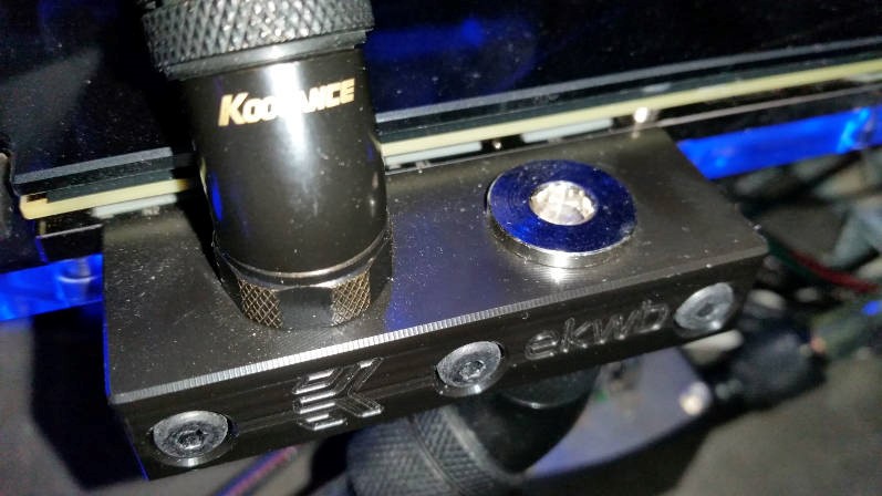

These are what I meant by silver disks - they could have course be painted/anodised in black or some other colour:
My connectors are 'in' at the top and 'out' at the bottom so I have one blanking plug at the top and one at the bottom. You, by the looks of it, will have two blanks at the bottom and both fittings at the top. The blank just plugs the hole which goes straight through the block so you can attach a fitting either top or bottom.
Ok, if you have one of those it's because you have two graphics cards. You want to be very sure that if it's the top card leaking, that it hasn't leaked onto/into the bottom card.
Those terminals replace the black part you can see in my picture so there is a seal between that acrylic block and the block on each card. That could be leaking or it could be any of the places where a fitting connects. If all the fittings that are screwed into the block (and the blanking plugs) are hand-tight and the screws that attach the block to the card then it could be that a seal has failed and OCUK can replace that under warranty - you're just trying to eliminate the easy-to-fix problems rather than repair the fault here.
Looking at the pictures, it seems to be the dual parallel block you have so it'll have a single blanking plug on the right hand side from what I can tell.
