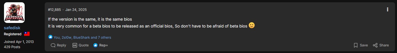

I dont have a problem personally flashing beta's, if theres an issue or somethings not working right I just back flash, if I can find the link i'll add it to this post, Safedisk (the bios writer) said don't be afraid to flash beta's, most beta's just go straight to final after a little further testing so end up being the same as the beta.
