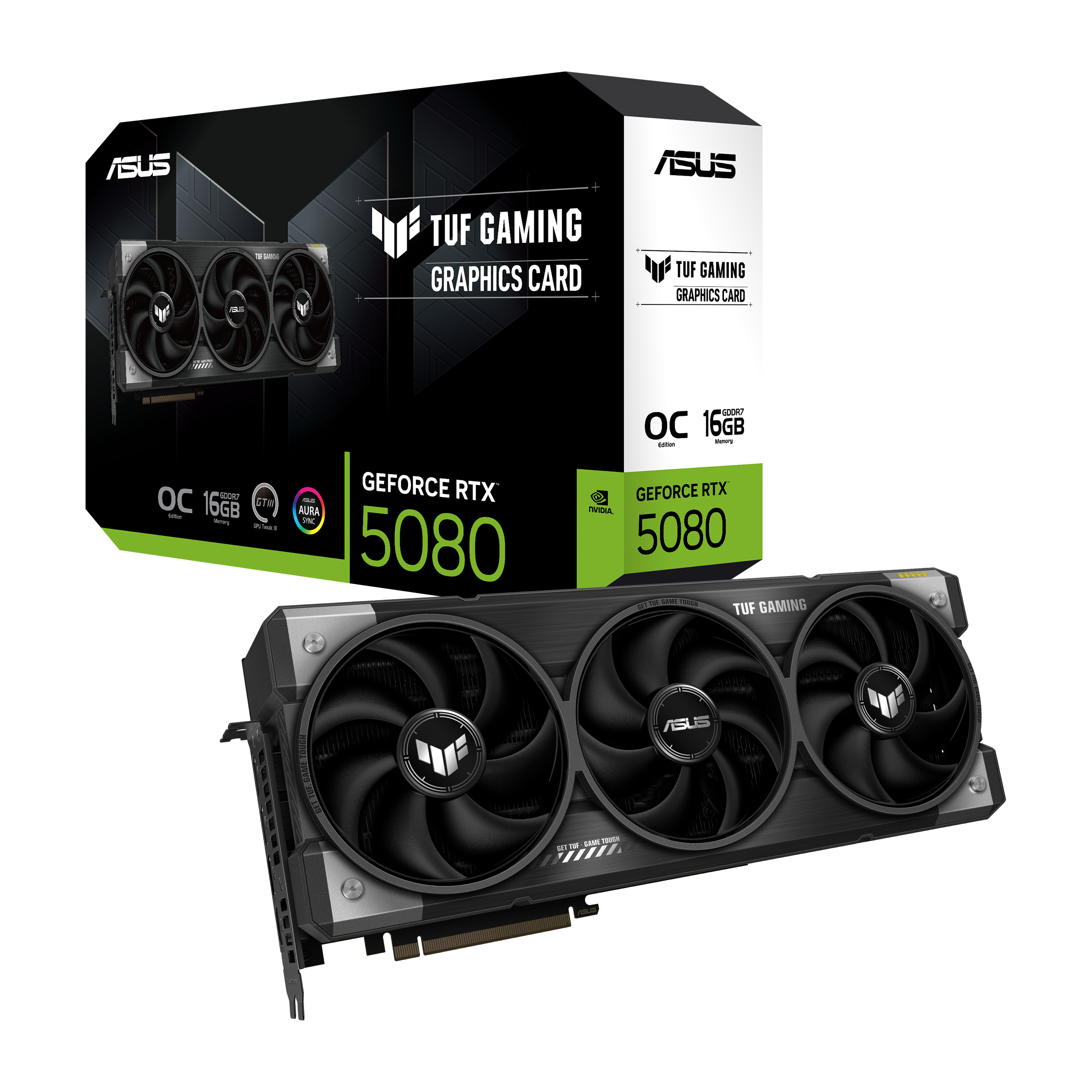

What I have come up with so far is the below but I'm unsure on mobo and GPU - I would like to stay with a 5080 and wouldn't want to drop to a lower card but which 5080 is the question, which is the best or are they all relatively equal?

I'd be more inclined to go with something like this:
My basket at OcUK:
Total: £2,443.82 (includes delivery: £11.98)​
You get a 5 year warranty with Zotac, 3 as standard and another 2 if you register within 30 days.
The Thermalright HSF will perform within a couple of degrees of the Noctua at a fraction of the price. There's actually a version of it for £30 but it's not all black, I can't tell if the case you've went with has a blacked out window or not, you could save another fiver on the RAM too if not.
T500 is about on par with the SN850X but you save a few bob, similar story with the RAM.
It could be worth spending another £50 on the Zotac Solid (non Core) version as I believe the HSF is a little better, but I'm not sure how much of a difference there is or whether you'd be likely to notice it.
Regardless, it'll perform identically and save you best part of £400.
Cheers, I'll amend my basket to the Zotac and take a look on those other points too.
