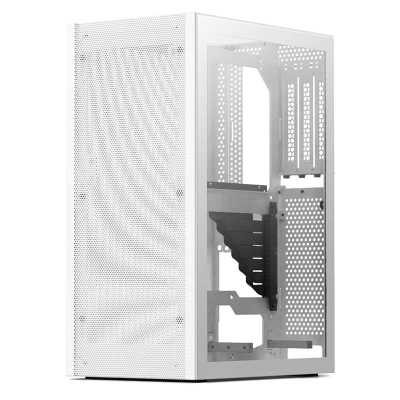

Hi All,
Looking for any advice or guidance for an ITX build for my wife as her work laptop struggles to have a game running with a youtube video on in the background.
The use case is a few games, nothing demanding, Runescape is the main game with the occasional Sims and other light-weight games, shes not interested in anything FPS or graphically demanding, she has 3 1080p monitors.
She wants a plain white case that will be mounted under her desk and it needs to be small, basically she never wants to see it.
I have a Ryzen 3800X spare to use, but OCUK dont have any ITX AM4 Boards so i have found a Gigabyte B550I Aorus Pro ITX board For £160, that should allow me to drop the 3800x in and be ok?
Budget is around £500, happy to go more if its worth it, or lower if not impacting performance or reliability.
Aside the CPU and Board, this is everything else im looking at.
Any advice appreciated.
My basket at OcUK:
Total: £514.79 (includes delivery: £11.98)​
