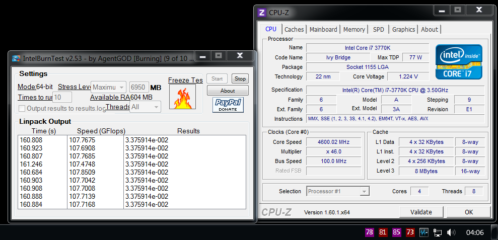

Ok mate, sorry it took so long in getting back to you, I have been running tests all night long and decided that after I seen the real cpu tempreatures with the "latest" edition of AIDA64, I thought noooo, thats a bit to close for comfort to the 100c mark, I was hitting temps on a couple of cores like 92c etc, so I thought to myself, lets use the head here, drop it down 100MHz from 4.7 to 4.6 and that let me get my voltages and tempreatures down to a more reasonable level (see the attached picture).
Eventually I got 4.6 stable @ 1.230v, so thats a drop from the 1.290v I was using for the 4.7 OC, and the temps came down a bit too, a bit safer I guess especially as I want to try and keep this system for maybe 3 years, lol.
As you can see in the picture though (if you can see it), I am stable at 4.6 with the 1.230v, but I have noticed if you look down at the temps, core 1 & 4 are always cooler than cores 2 & 3 which you can see (when burn testing anyway), why is that, is that normal ? (by the way, that was slap bang in the middle of a miximum stress test on intel burn test as you can see, so the temps are ok, I think, are they ?), when I had it at 4.7 & 2.9v I was edging into the 90's, lol.
But, soon as the system is idle now the temps drop down to approx 30-35 on all cores.
All these tests were done in the room here which at the time was approx 26c degrees give or take a couple of degrees.
