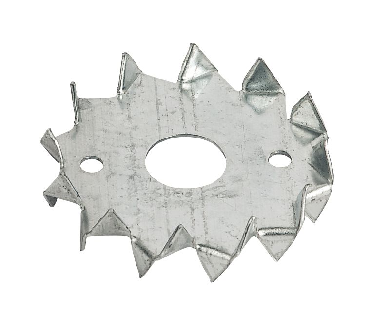

Ripped down ceilings and the small sloped parts in my 1950s house, as I thought no insulation there. So I’ll be insulating there.
However my question is more to do with how the joists are fixed to the rafters. Some of them look twisted and like they are separating. What you can’t see is there’s a piece of wood on top of the walls, presumably the rafters are birds mouthed and fixed to that. As well there is a purlin attached to all the rafters in the loft space. The joists then seem to be entirely supported by the fixings to the rafters. In this room they span around 4m.
Looking for hangers and most seem to be for when joists and rafters butt up, whereas these are side by side.
I guess one option would be to put some structural screws or nails through. Would prefer screws, easier.
Any advice?
Thanks. Pics below:
