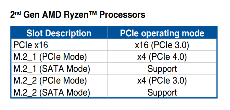

The X570 gaming-i manual states that it only supports PCIex16 Gen 3 on Zen 2 chips (which the 3900x is), When we looked at GPUZ it was shown to be running at PCIex16 Gen 4, hence the decision to drop this back.
The weird thing is that the manual also states the board supports PCIe 4.0 x4 on M.2_1 for Zen 2 chips but I can't can seem to figure out why it defaults to Gen 3 or where to force the Gen 4 in bios.
