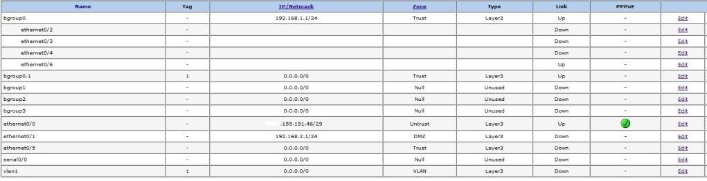

Hello all,
http://i1137.photobucket.com/albums/n517/mikejrg/ssg.jpg
Following on from my thread about connecting an SSG 5 and Cisco 881 together.

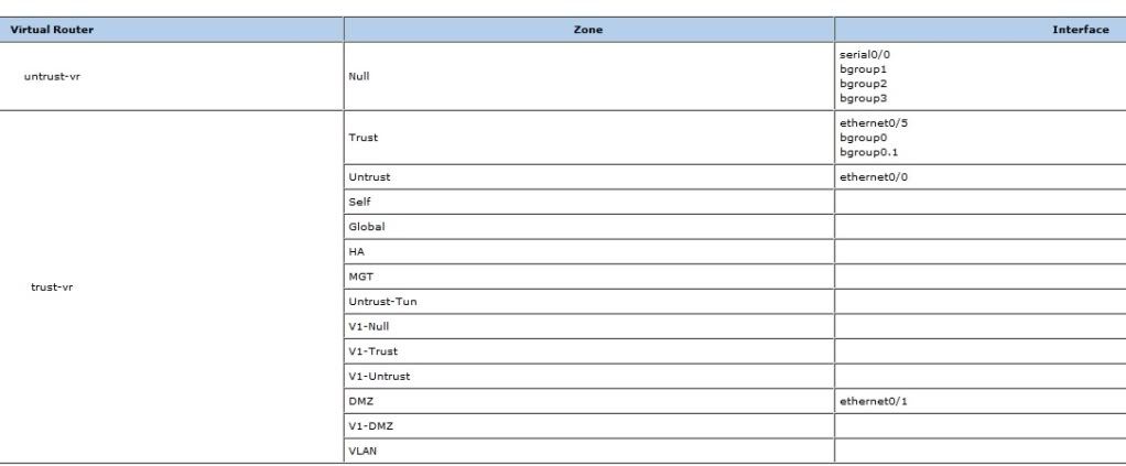

I have tried to root Public IP's from my Juniper to my Desktop PC as a test but to no avail, current setup of ports is as pic attached. I have been trying to use Ethernet 0/5.
Does anyone know how the switch port would have to be configured, I am running NAT atm on the device as well.
I have a /29 with Zen.
I have tried different zones and the like to no avail.

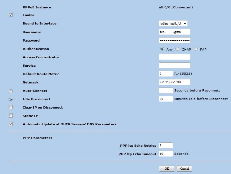

Many thanks all, I had to change the netmask on the pppoe settings. That looks like the below

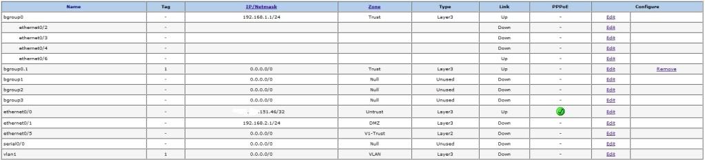

With that my interface list is as below

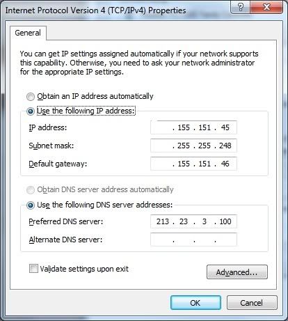

I then tried to hardwire my pc but to no avail

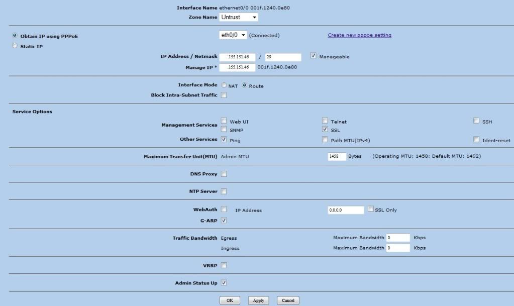

The ethernet 0/0 properties are as below

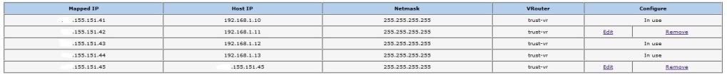

I created a MIP map as below
Zones are below
Basically I want to have the SSG 5 firewall the connection, then I connect the Cisco 881 behind that.
Do I need to create another group to pass down public IP's.?
