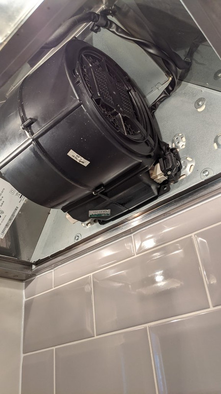

Hey guys.
Everytime we cook, the kitchen gets awfully steamy/humid to a point it even sets the hallway fire alarm off.
The extractor definitely isn't doing much. It functions, makes all the correct fan like noises but doesn't seem to really do anything.
I took off the aluminium mesh filters to get access to the motor etc. Sort of feels like it's blowing air rather than pulling it in?
It's never really seemed right but lately its worse
Any tips appreciated
^^this side blows air quite a bit
This side feels like it's still blowing air but much weaker than the left side.
I haven't a clue about these so any help appreciated

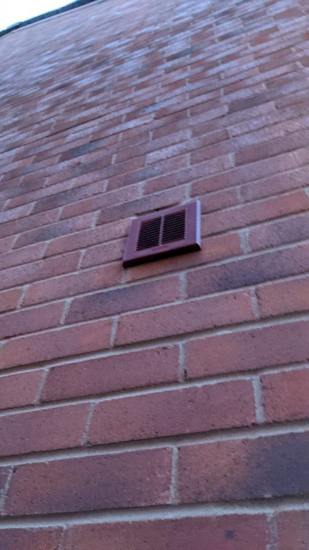

What noob said ^ , put it on full whack and get on some steps outside. Maybe the vent hole in the wall needs cleaned out.
this is where you find out theres no hole:) when the fil had his new house built the kitchen fitter didnt put a hole in the wall assuming the builder would was fun and games :)
That must be brand new - wish mine was like that -dripping of oil but still sucks air outside and moisture.
Looks similar to mine. I had to completely reroute the ducting, by drilling a 6" hole in the correct place because the kitchen fitters had completely bodged it by using undersized 4" ducting and bending it at right angles to match up with the incorrectly drilled hole in the wall, so it barely functioned.
You'll probably find it's blowing air instead of sucking because the duct above it is restricted.
Do year hear a change in noise as you change level or does 3 sound the same as 1.
If they all sound same I would say either hose is restricted or more likely too small in diameter.
I'm not sure how loud they should be but it seems a bit noisy to me. Yeah definite change in fan noise between settings 1 thru 3. From a small plane to a Boeing 747 I'd say.. ok not THAT bad but it's not subtle
@kinger8938 yeah they are not quiet appliances :D think yours is an electrolux group one from photos you posted most common things I see with hoods are usually install related or customer expectations.
Do you start it when you start cooking or to clear air during?
Also hold a pice of kitchen paper just under the mesh filter and see if it sucks it up.
