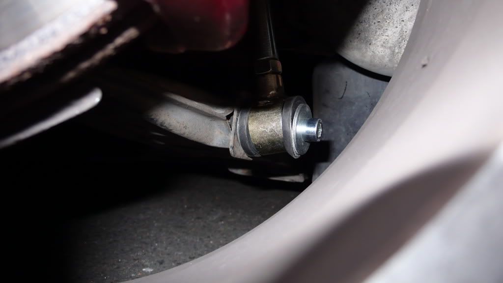

how ever the pop is still there, having a quick look under the car i saw this site which JUST AIN'T RIGHT !!!!
Img time
that ain't right but at the top looks fine

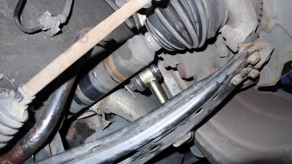

See looks good.

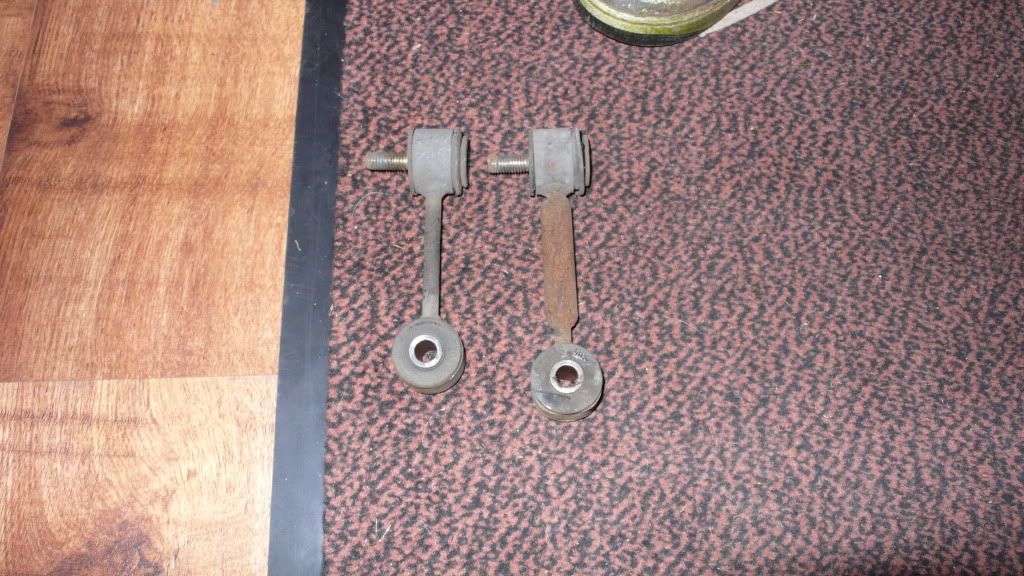

These are the old ones that came off... looks like someone wrapped the drivers side one in metal then welded it together ?!?!

saying that tho doesn't that first photo just look WRONG ?!?!? (and now it's not threaded LOL it looked fine before i dropped the car to the ground)

Again tho, does the top pic look ok to any one ?!? cause it doesn't to me !
:rolleyes: Yer that was me.... i disconnected the Anti-roll bar to see if the knocking stopped..... and didn't really think about the drive shaft hitting it... Oppps

it's spanking new... and at the same angle as the old ones (that came off the car) both side are like that !! and shes not even that low..
