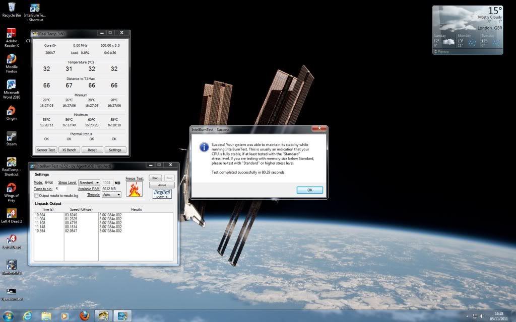

I have a 620 and a i5 at 4.4Ghz and in IBT my max temp was 60oC.
This was using one viper fan, since the screen shot I have added another viper fan so should be getting even better temps now.
