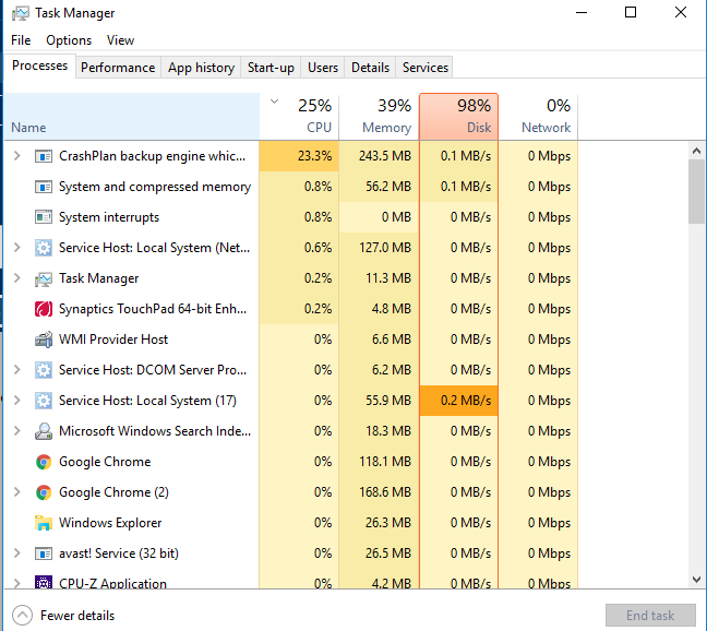

Hi All,
My Laptop has been running quite hot and slow recently, every time I have tried to use it (browsing on the sofa) and is getting to the stage where it's quicker to use my iPhone.
Is there anything anyone can suggest??
Thanks,
Dan
Has this just started happening recently or has it slowly got worse?
It looks like something is smashing your disk in the top screenshot, although it's difficult to know if it's just a temporary thing with out seeing more. In the bottom screenshot it does look a little toasty, but doesn't look like any thermal throttling is going on. You will be able to get a better idea of the problem if you take a look through resource monitor. If you're experiencing almost complete lockups, followed by periods of normal performance, I'd suggest looking very closely at the disk usage in resource monitor while you're experiencing the problem.

It is becoming more and more regular and the fans seem to be 'kicking in' (suggesting load and heat) when i'm doing very little. Right now i have only google chrome open with this tab open only and the fans are quite loud and the temperature reading is 88-93c and just opening resource monitor takes some time (which i dont think it should considering the specs aernt that bad)

ok first things first what is eating up all that disk usage? u need to do it again under disk usage priority to see whats eating up all the resources, 98% of hard disk being used, thats causes a lot of heat to go around the inside that could be 1 reason, i have my old sony vaio 5400 rpm hd it does similar it gets really hot anything with hd heavy resources and the whole laptop gets hot as a result.
