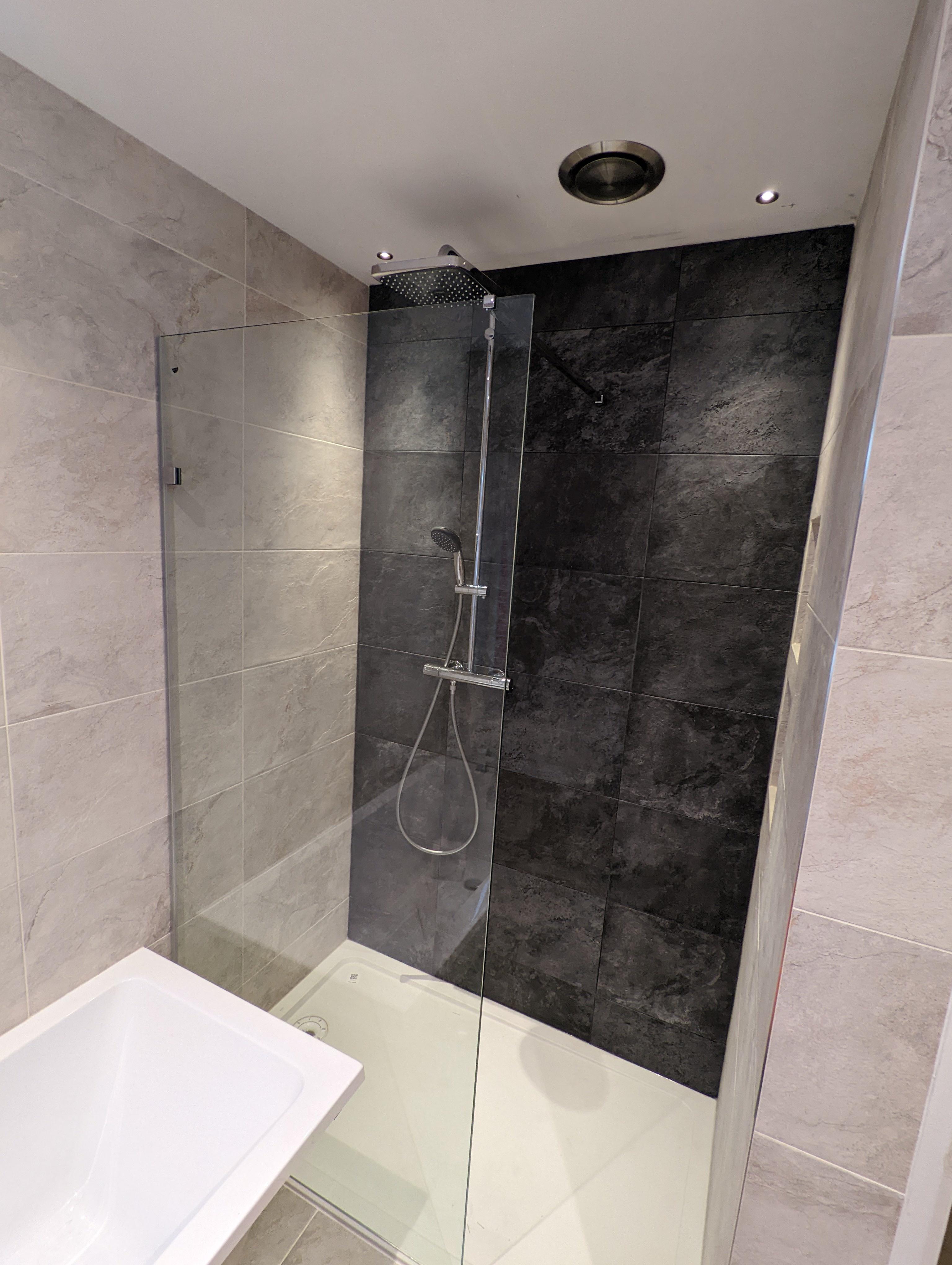

Mine below was "stealing" room out of a stud wall rather than creating false walls though, so I was limited in space. You will see the lights are small focal lights above the shower.
Before /prep
Here's mine before finished (the grout marks etc have since been cleaned :D)
Semi Finished
