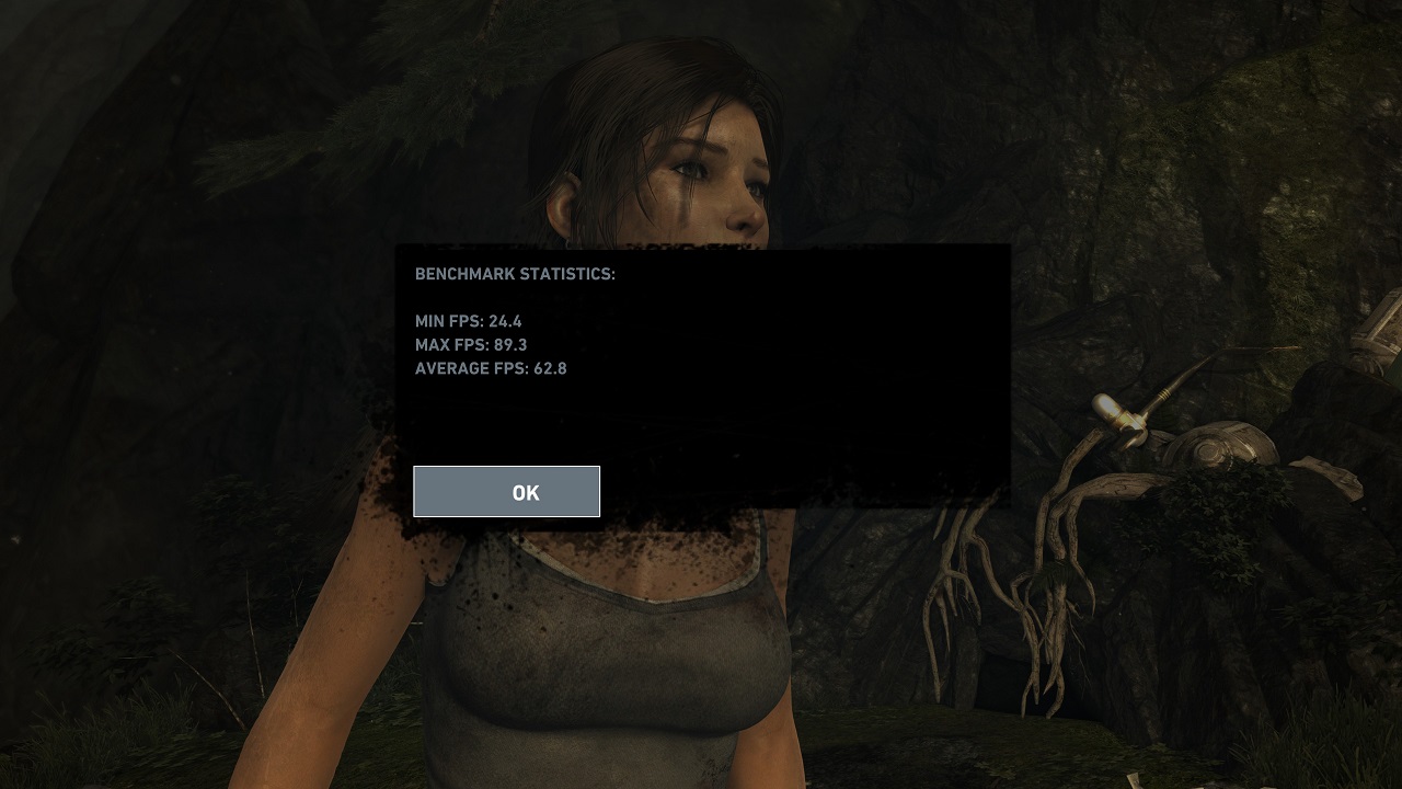

If he tried 4 x 290X cards with the 5820k the drop in performance would be terrible on some games and I would like to think in his position he knows that. I have posted benches before with 4 cards @4K using PCI-E 2.0 and 3.0, as we know PCI-E 3.0 x4 is the same as PCI-E 2.0 x8. When switching between PCI-E 3.0 x16/x8/x8/x8 and PCI-E 2.0 x16/x8/x8/x8 the performance goes through the floor with the 290Xs on some games @4K and the Titans also suffer quite a bit as well.
Just ran these off for Linus benefit to show the 4K scaling on 4 cards lol.:D
290Xs @1200/1500
4930k @4.0
Tomb Raider totally maxed @4K
One card
Two cards
Three cards
Four cards
You get the same sort of scaling in lots of games on both AMD and NVidia.:)
