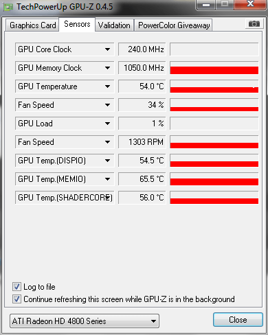

its maybe heat thing then, if it happens when you game but now you got side off its ok its prob gfx card overheating, download and run gpuz and use log to file, put side back on and test it
How does that look, bit warm? Its a 2gb 4890 sapphire vapor-x

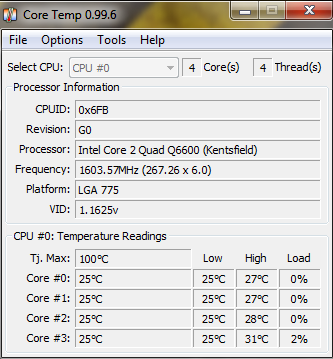

My Coretemp is

Temps look fine. I'm thinking it's your PSU, since Jeantech aren't exactly a highly known company for PSU's. Also you only get crashes or reboots during games right? (so when the PSU has load) it looks like the PSU could be an issue.
