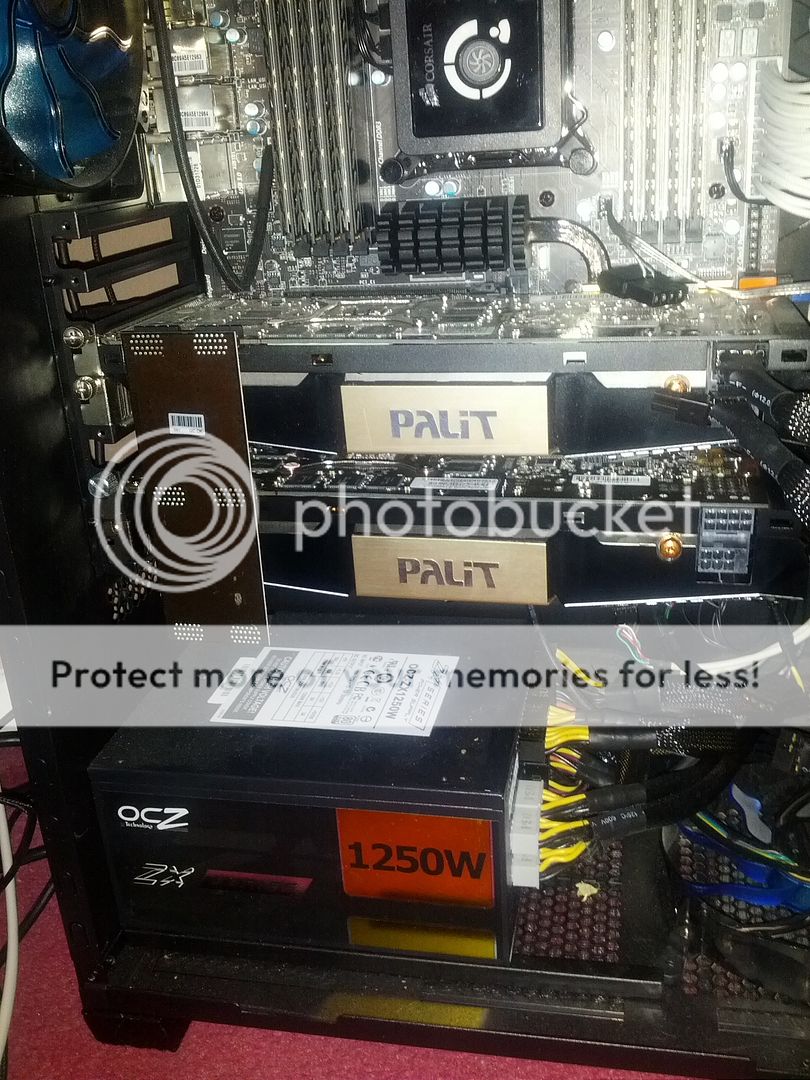

Hi, has anyone managed to Sli 3 large cards on here, my cards use every 4th lane so I need a cable to reach from PCIe slot 1-7 I have a 120mm cable but I think it needs a 150mm if they make one?
If not has anyone made or seen 2 soldered together? Thanks
No only comes with a 3 and 4 way that run at 1-3-5-7 its a bit stupid realy, i had this problem 2 yes ago with some 5970's.. Looks like a diy job then.

http://i712.photobucket.com/albums/ww122/crezzlin/IMG_20121222_080039.jpg
Ahh, you have a 3 way solid bridge.
I take that bridge in the link was what you were looking for?
Yes it was but I didn't realise I had the 3way one that fits... Like you said it will hit the cooler shroud I also had that in my head thinking it wouldnt fit but it fits nice. :)

After all that the MSI big bang will not run cards in lanes 1-4-7, lane 4 goes to 1x speed once lane 1 is in use... The Asus extreme will do it do I'll need to do some swapping but still no 3rd card yet Lola
