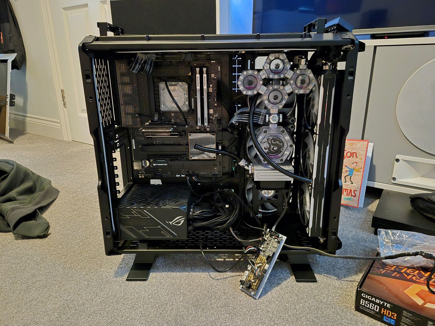

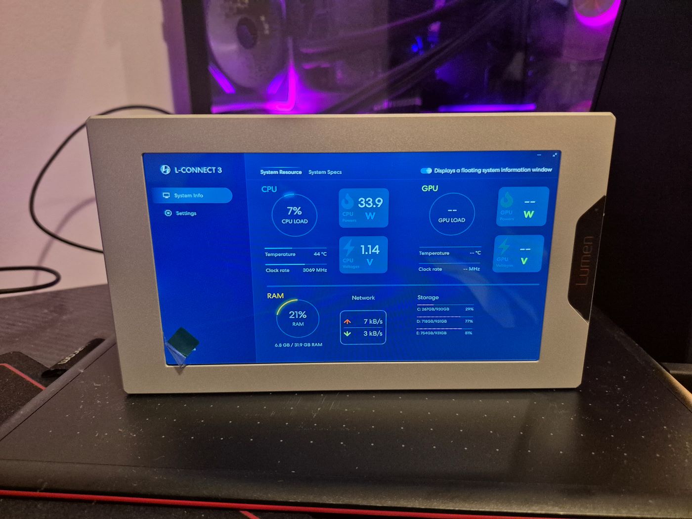

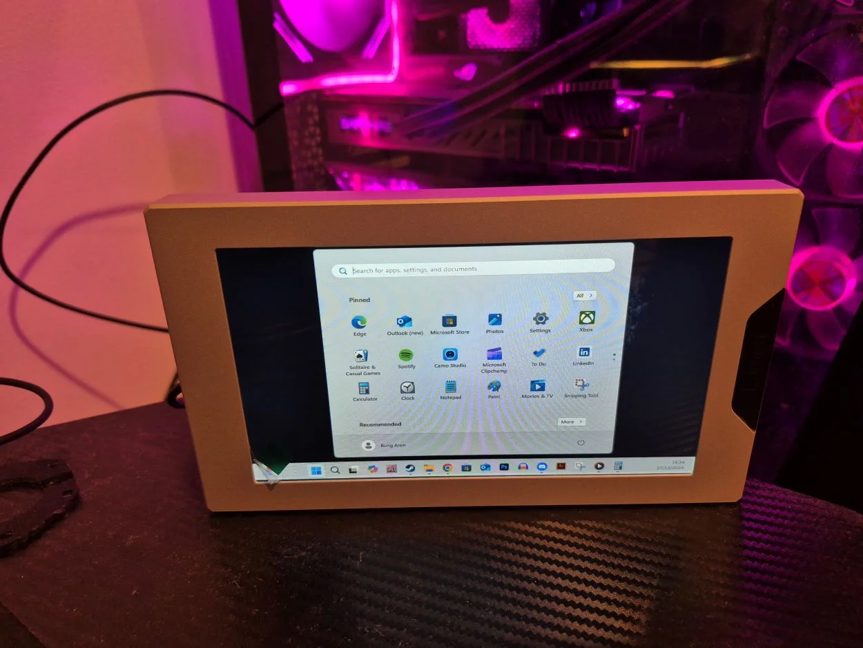

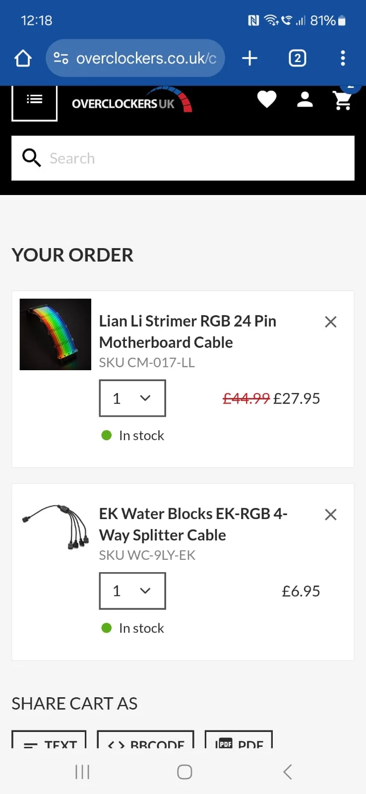

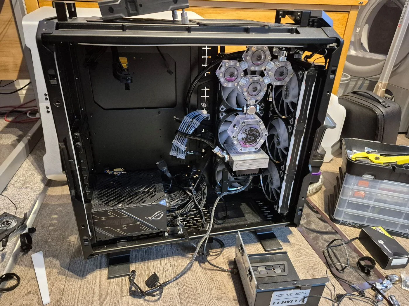

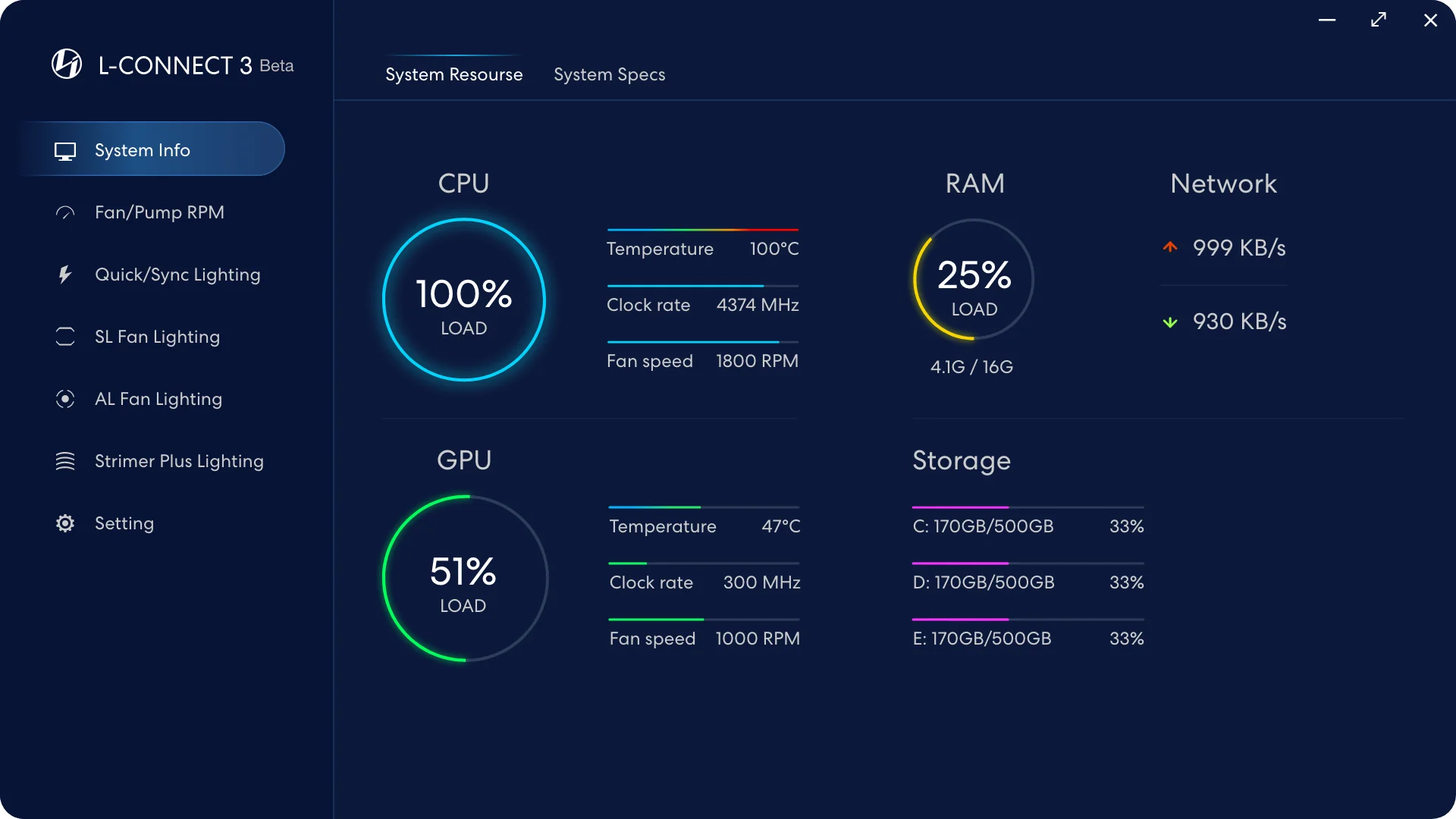

So aye. Two custom made black EPS cables and a Strimer, and one finished RGB thing. Will hook up the EK screen shortly to make sure it is good. I am hoping Lconnect shows on that and scales...
If not I will have to buy AIDA and pee around making my own.

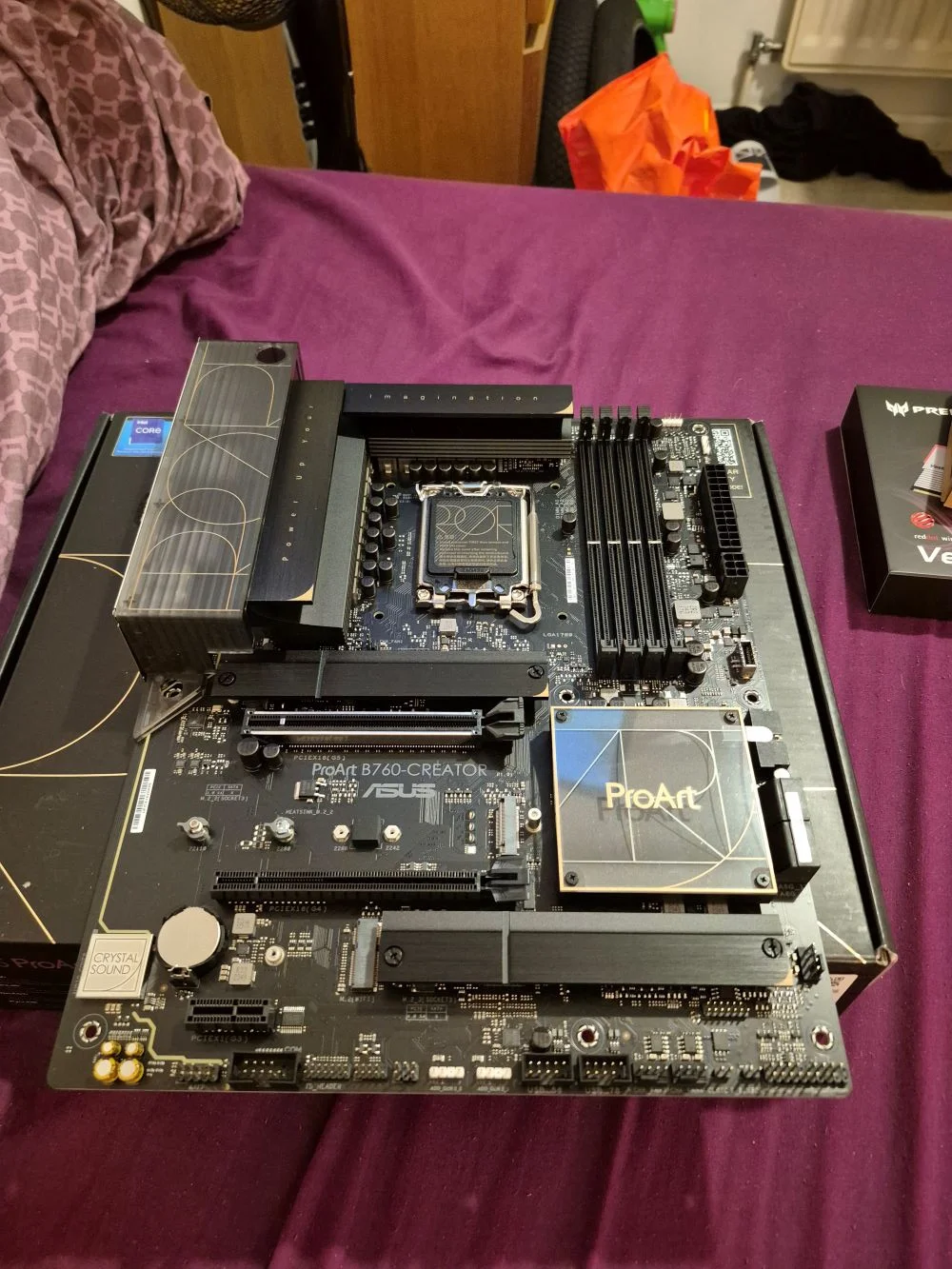

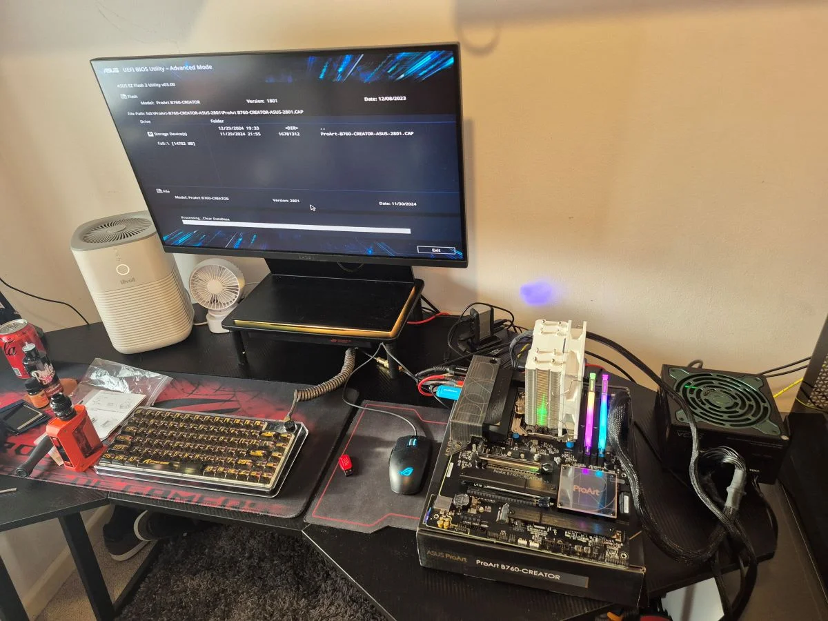

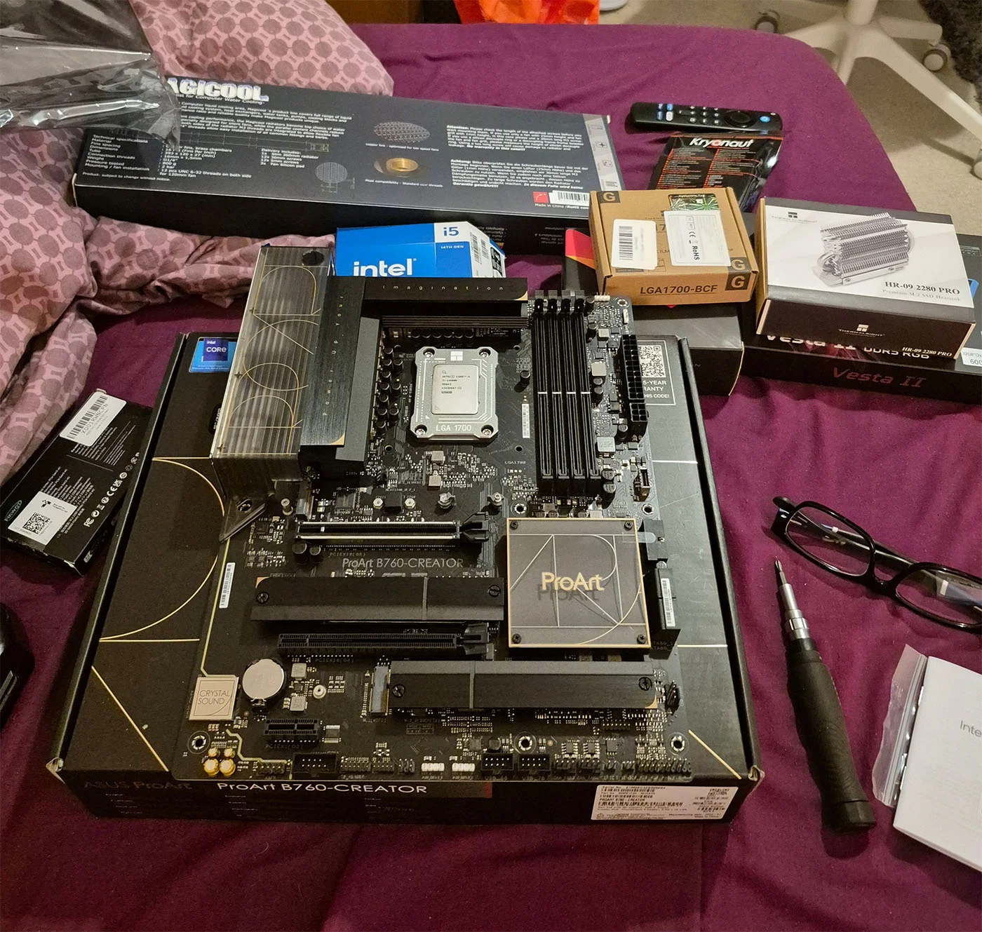

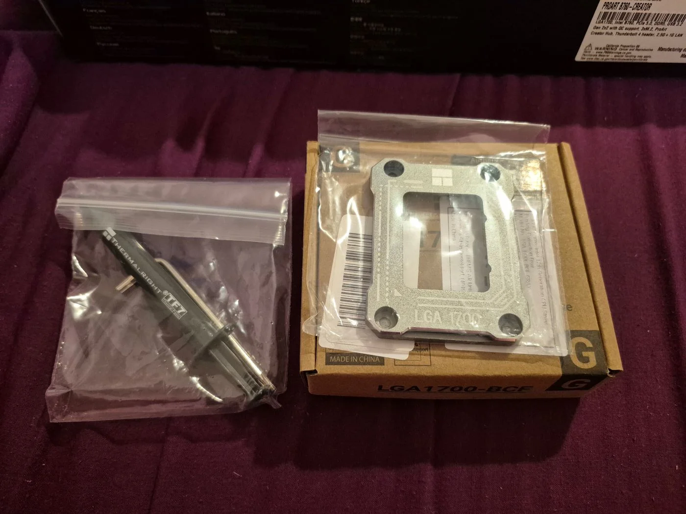

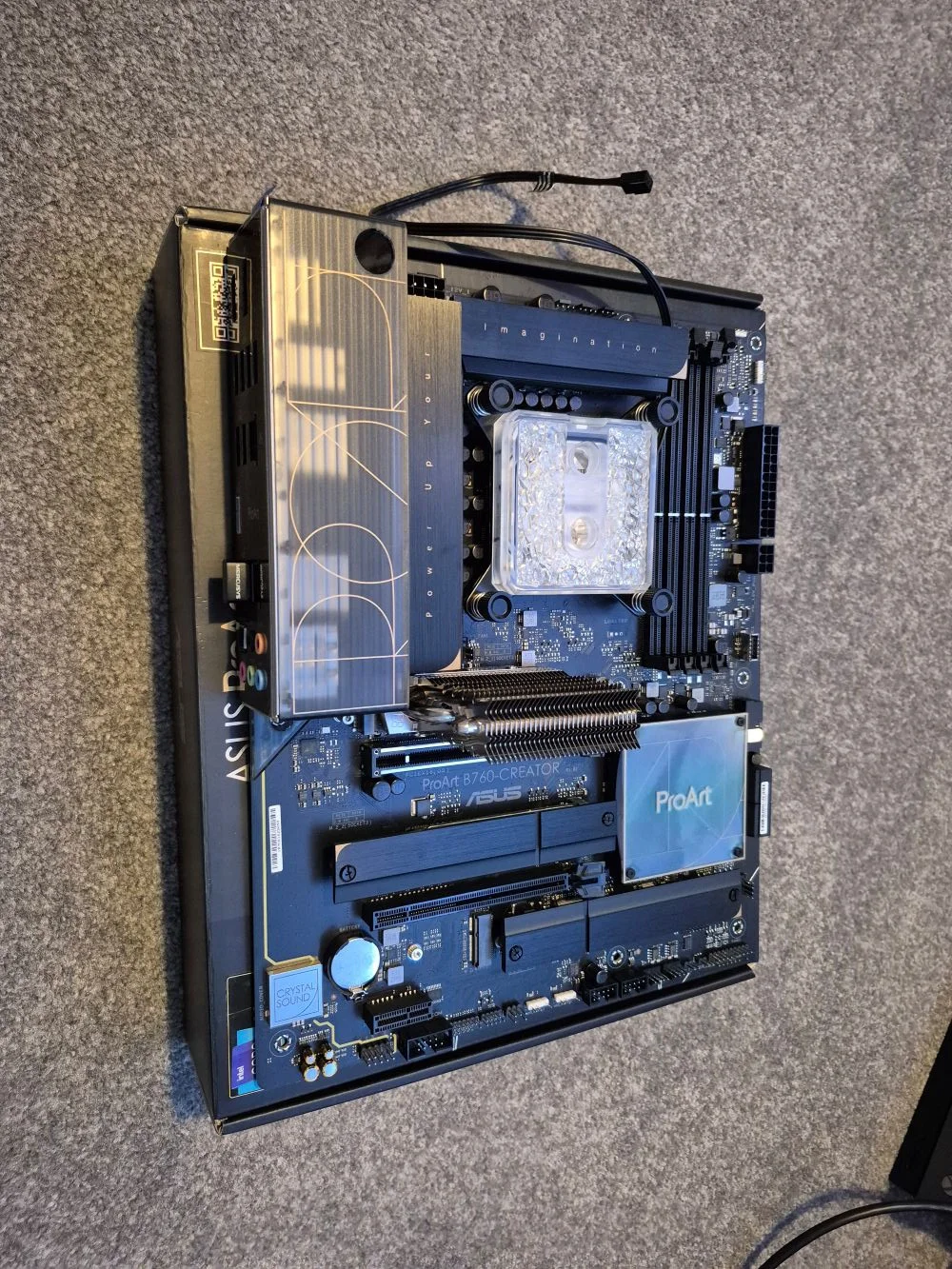

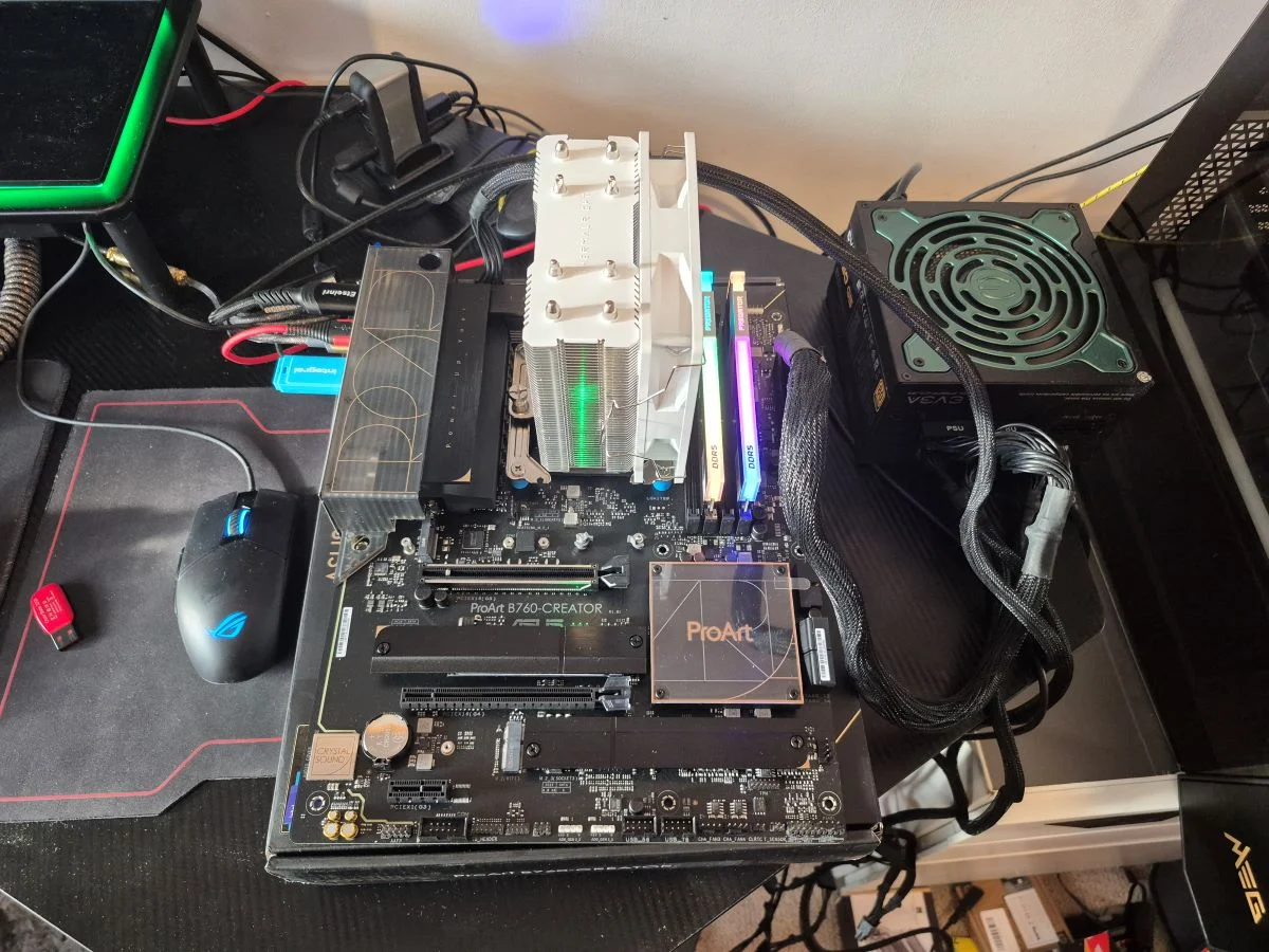

OK so things done. Remove retention (squeaky bum time). Fit CPU, install frame.
I then removed the top NVME cover and reversed it. Like, 180'. It then fits the middle one. 1tb installed in there. The big old Thermalright one will go up top on show. Part of me wonders why they couldn't just add another fiver and give you three, but I suppose then it looks the same as the one costing 3x as much. My little hack on the other hand makes it look that good any way.

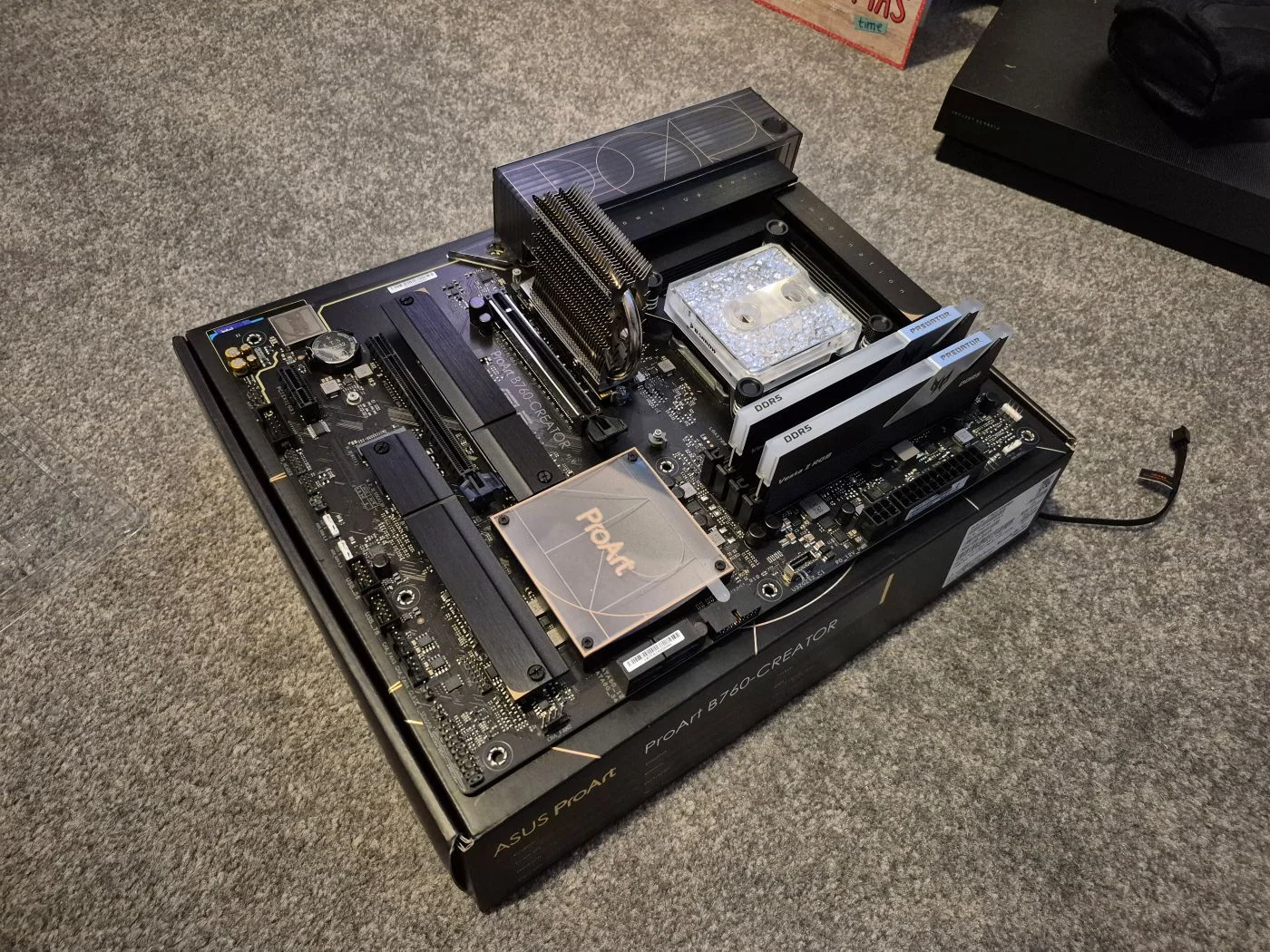

The CPU block concerns me. They provide the block, one set of post screws with springs on and another without. No instructions and no labels on the baggies to tell you which are to be used for which. I hope Barrow have instructions on their site ffs.
Also Ross.... They are M3 now. So I guess they realised like every one else that M2 sucks monkey testes?? I mean even tapping M2 is a bloody nightmare.
They are M3 now
Good to hear. The posts I have suck bawls lol
Assuming the mounting is the same, I just dug out my brass one and refreshed my memory. On mine I have a plastic backplate with threaded inserts on each corner, those inserts are just long enough to poke flush with the top face of the motherboard. I only have 4 of the post thumbscrew things and they have springs. The posts go through the block's mounting plate with the springs above the mounting for pressure, and just dial them in.
Because the block's mounting bracket is just through holes, the only thing that can even keep the block in place would be the springs. I presume the extra posts you have are just spares.
I actually got paranoid about inconsistent pressure because as I was measuring real-world install height so I could update my CAD model, I noticed significant discrepancies in height from block top to motherboard face on each corner. It was like trying to level a bloody four point printer bed lol
This is why I'm looking at bodging a different mounting mechanism :P was originally looking at my spare EK Supremacy EVO but I think the knurled portion of the mounting posts as actually taller than the space underneath the Barrow's mounting bracket; the EVO's coldplate is thicker than the Barrow certainly.

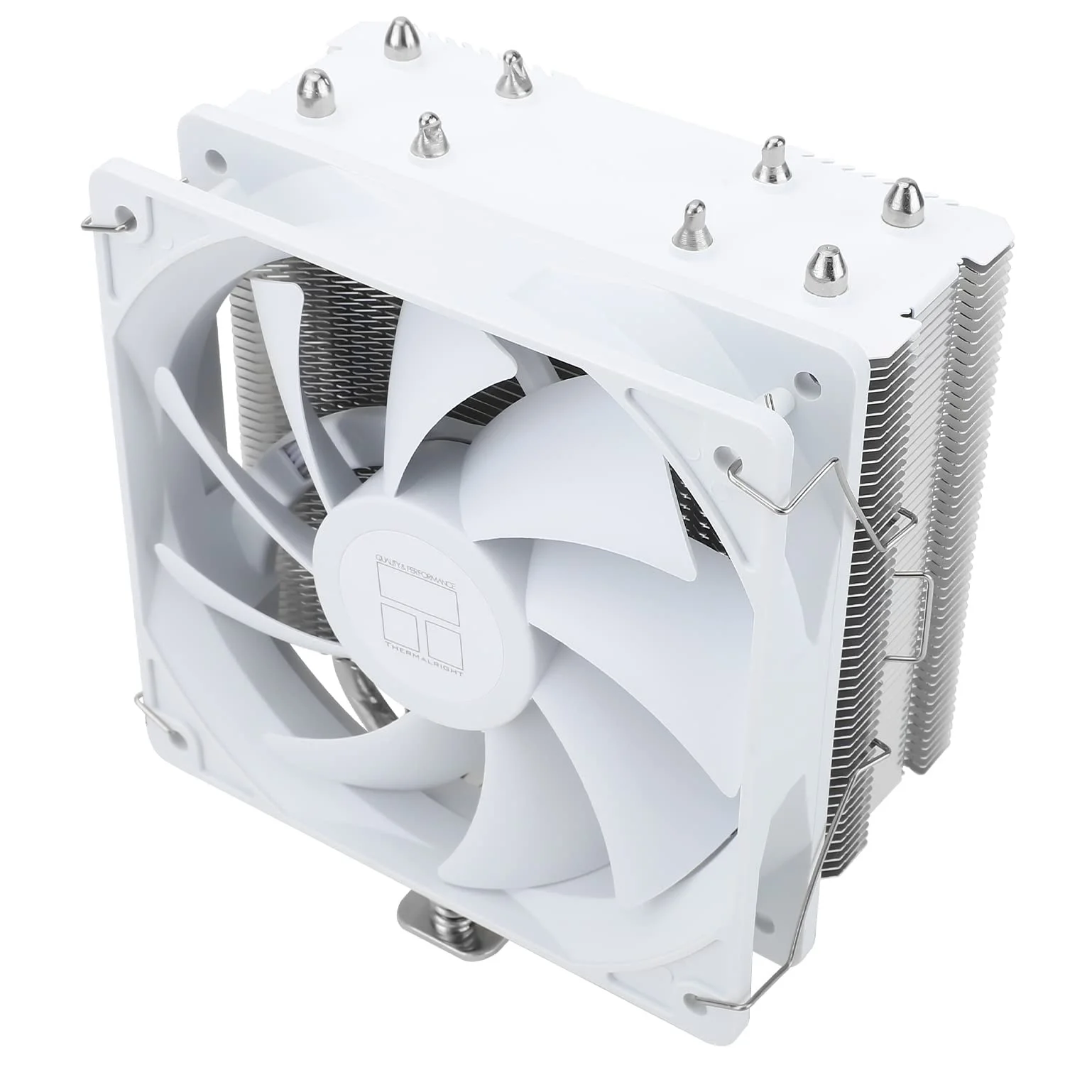

Meh I crumbled. £15.99
I am not going back until Friday, and I know NYD will be boring. I can also literally install the entire OS, all of the software I need and so on. I don't have any spare air coolers at all so I need one any way.
Well it all works lovely. RAM timed perfectly too. Just one issue... No wifi, so Windows is stuck. FFS.

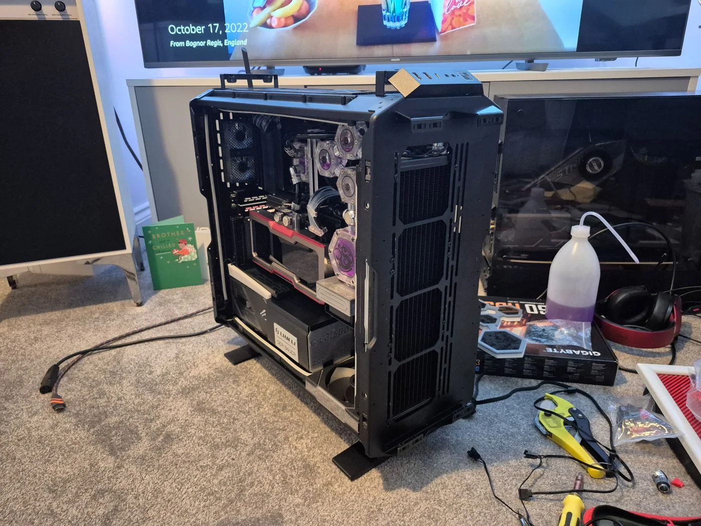

So to catch up. I got home on Friday and started to strip the PC down.

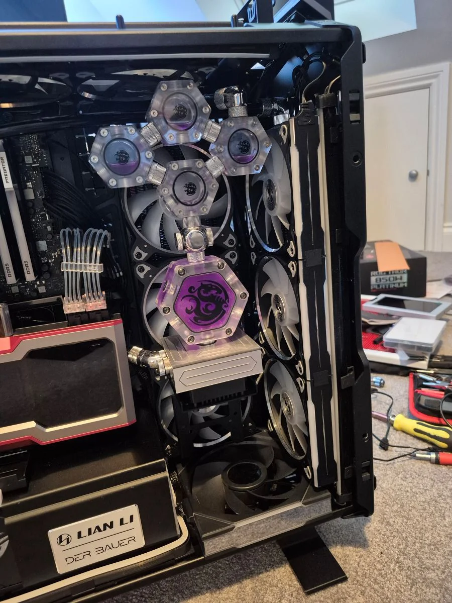

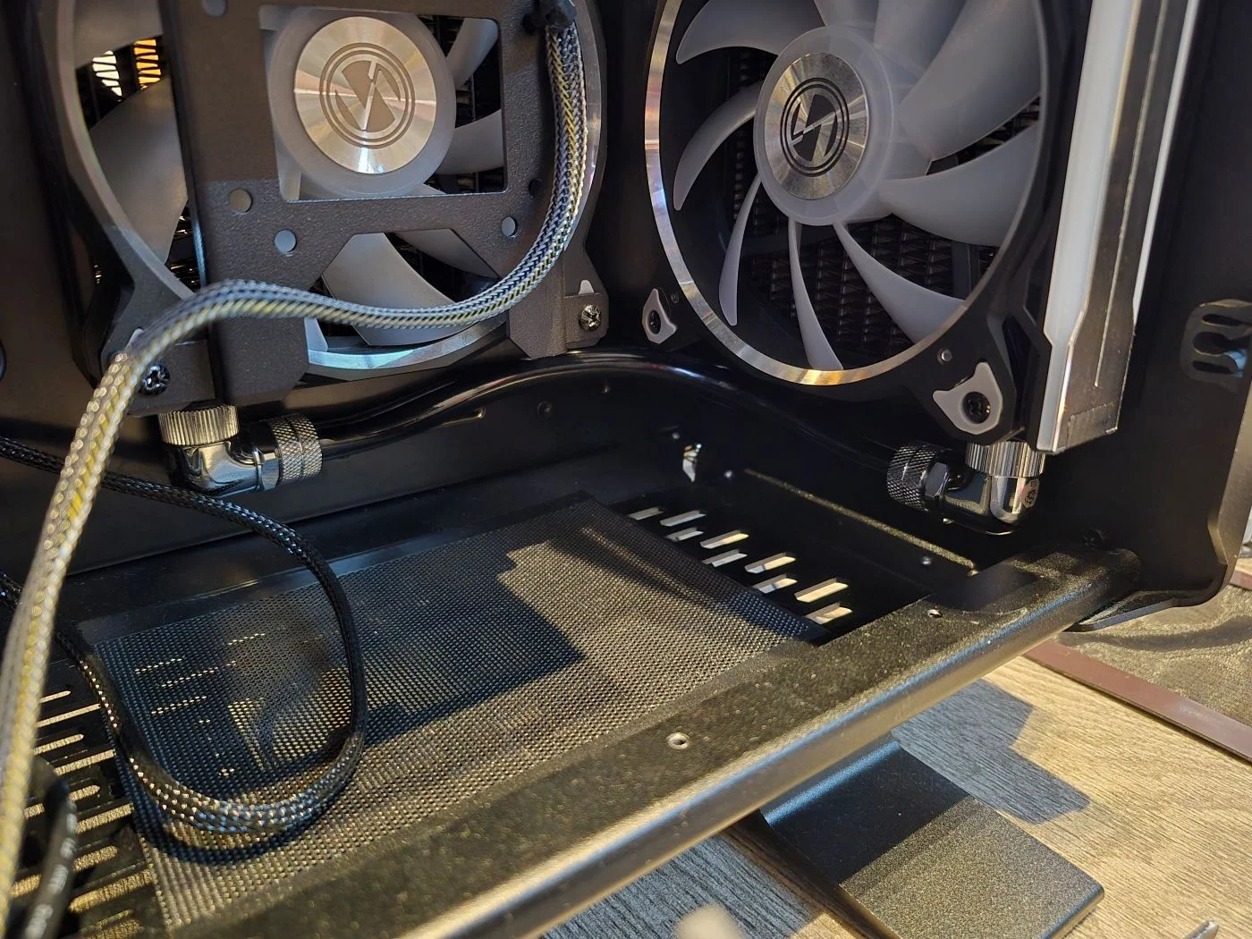

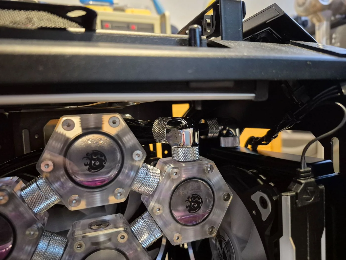

After which I installed the new second rad.
End tanks are linked down here.
Not much else needed changing apart from a new return line. That is up here.

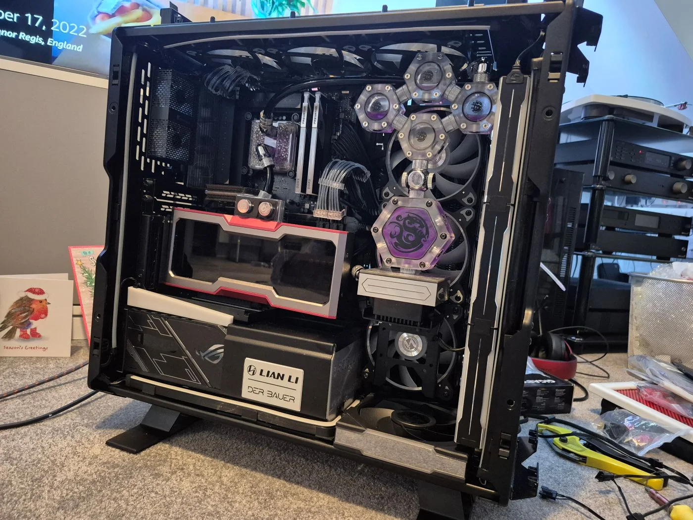

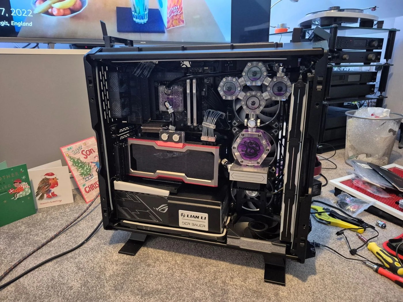

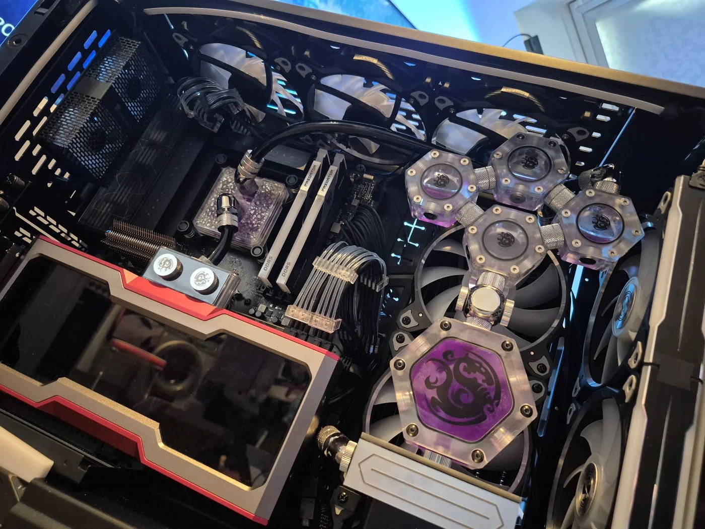

Unfortunately I had a spill and the GPU had to come apart and be dried and rebuilt into the block, as well as all of the boards and stuff in the bottom.
Then I fitted the board.
The long return hose will go into the CPU block at the top... I think the hardest part of that was fitting and positioning the Strimer EPS that never existed and stopping it fouling the fan. I got there eventually, however. Now obviously the rest was a known entity at this point, so about 7 hours later and it was back in one piece.
It is still enormously stealthy on the hoses which was awesome.

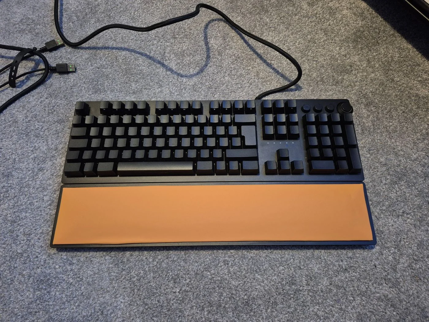

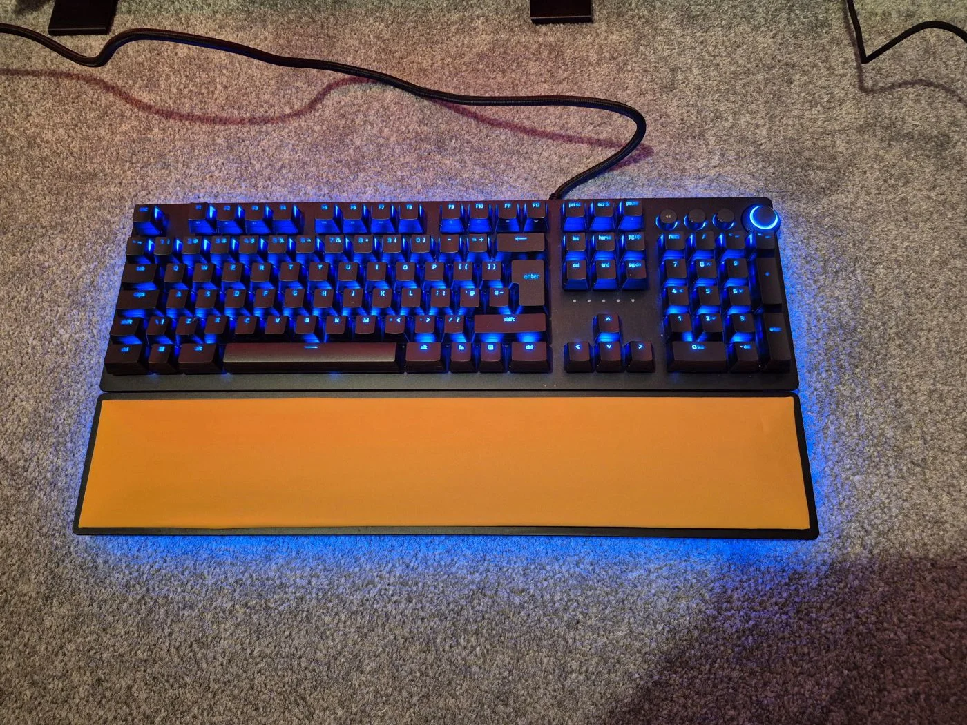

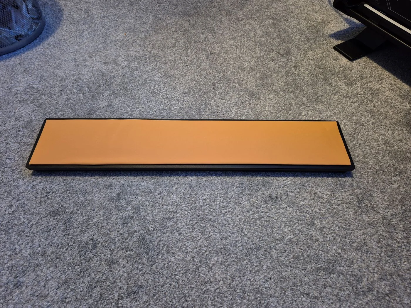

And then a side quest. I rebuilt my Hunstman Elite a while ago using phantom caps from Razer after two sets failed to fit. I have a spare now which is nice. However, the wrist pad pleather was rotten and falling to pieces. Cue Ferrari coloured leather.
Then.
Before finally
This is why they are called phantom caps.

It's still on the floor lol. It's all finished now but I'm addicted to Indy Jones and can't stop playing it. Mind you I guess I can excuse myself there to say I'm testing it properly before putting all of the panels on and etc. It's much easier to fix where it is.
That said it's performing amazingly. The new CPU has improved it a lot and it's much quieter now too. It's also only pulling 450w max rather than the 750 it was before. The TEC alone when running pulls 250w lol.
