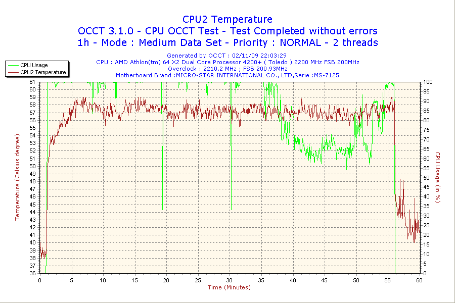

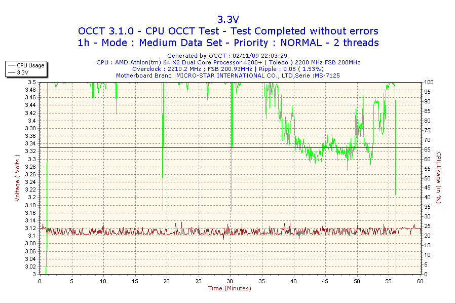

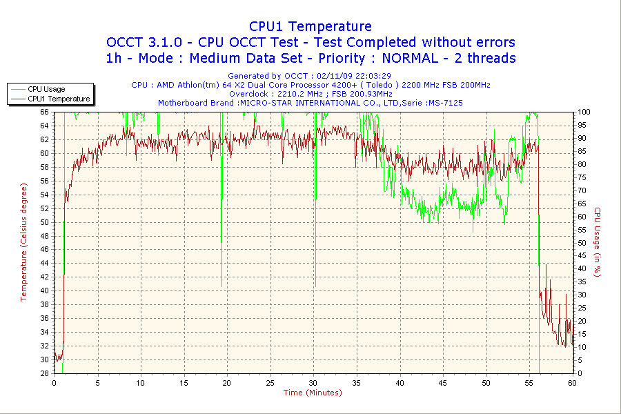

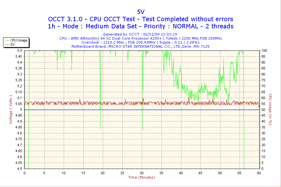

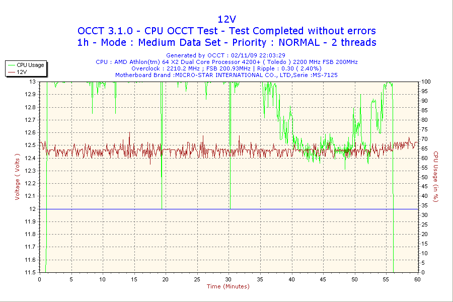

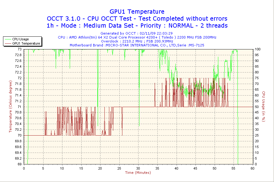

the test is running... 10 mins in the cores are sitting at around 61 and 58 going up and down 2/3 oc.
