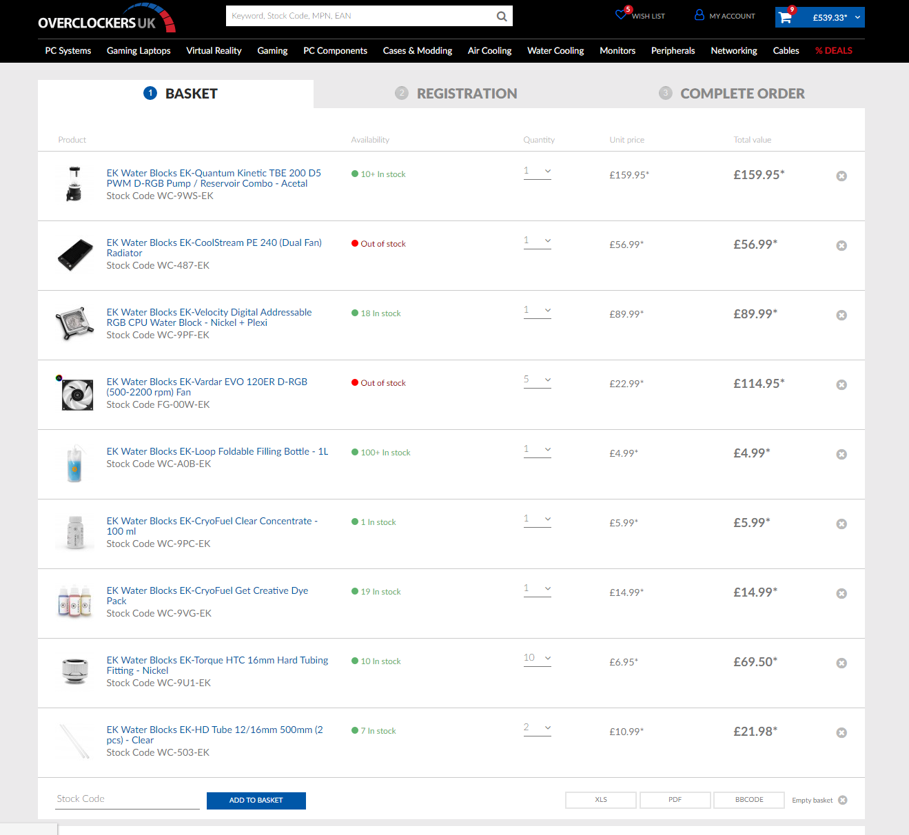

The kit you linked to is for SOFT tubing only, you will need different fittings for hard tubing.
You would need this ( based off the kit with extra fittings and fans for the 360 rad )
