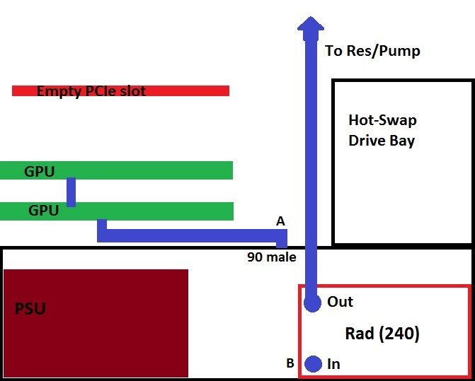

I have a small loop routing issue:
I don't know how to connect A to B including a drain port.
I'm using XSPC black chrome fittings with 19/13 primochill tubing.
From the bottom GPU I have a 90 degree fitting which runs to another 90 degree fitting at point A. This has a male thread which I was hoping to connect to another compression fitting with a Female-to-Female connector but I can't find any on OCUK.
After that I was going to put a T-connector in with a drain port off the bottom of the sideways T (below 'A'). Connection 'B' was going to be 45'
There's just enough room below the bottom GPU to run the tubing to point 'A' which I think is too tight to bend the tubing down towards point 'B'?
I don't really want to move the GPUs up as that would mean creating a custom link between the two cards (currently plan on using EKWB acrylic link & fittings).
Anyone have any advice?
Thanks Ragnahex! You have given me an idea!
That Bitspower fitting is ideal but will look a little out of place with my other XSPC black chrome fittings... so I thought this would work just as well:
YOUR BASKET
1 x XSPC G1/4" T Fitting (Black Chrome) £3.95
1 x XSPC G1/4" Plug (Black Chrome) £1.55
Total : £5.50 (includes shipping : FREE).
Just put a plug on the T-fitting I won't be using and hey presto! An L joint :)
I have a temp sensor on the inlet before the GPUs, hmmm.... maybe I should put another one after the GPUs on that T-fitting...
