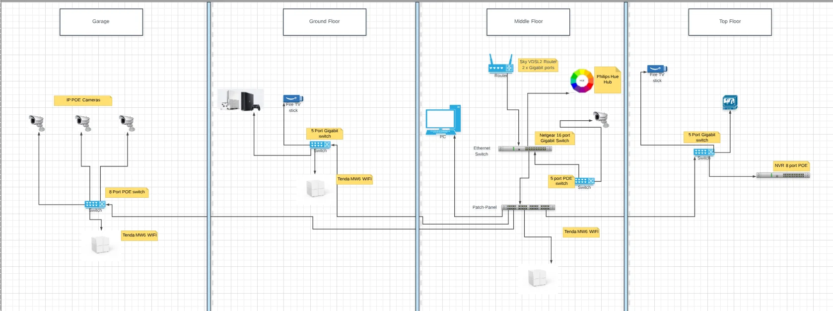

Here is the kicker, the internet never goes down - it only goes down on the network. I have a SKY router with 2 ethernet ports and when my pc is plugged in directly on the router I never lose connection, it is only when I go through the 16port switch that this happens. Problem is all other devices connected to the 16 port switch loses connection intermittently.
This is my network setup - WIFI devices are not shown.
How can I diagnose this problem?

Make sure there's only one cable from the router to switch. And only one cable from each switch to the next switch. And no circular loop.
I would probably statically set the IPs for each switch. Say the router is 192.168.1.1, I'd tell it to start the DHCP range at 1.10 then statically set each switch to 1.2,1.3,1.4 etc

How many cables from router to switch?
Asking because you list 2x ports.
Also, this Tenda WiFi.. does it expect all APs to be connected or is it meant to be a mesh system? Typically a mesh would be one device hardwired as a master then the slaves connected via WiFi. THIS MAY NOT BE THE CASE. I've never used a Tenda system.
Yes only 1 cable from router to switch.
The Tenda Nova MW6 is a mesh system than can be hard wired or use wifi to extend the mesh. I chose hard wired because the signal to the garage unit is pretty weak.

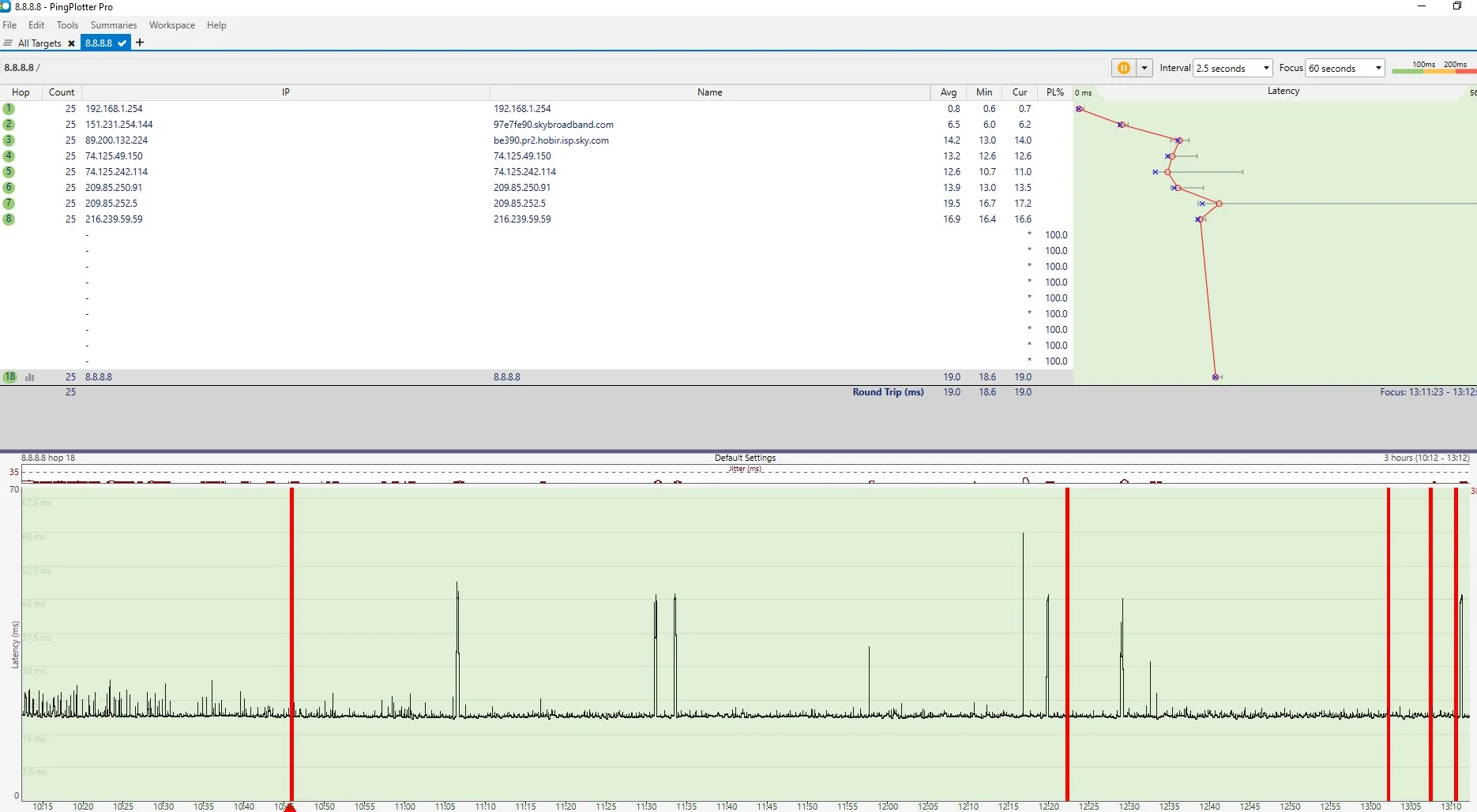

I have checked all devices and can't see any other that are trying to act as a DHCP server. The screesnhot is the result with the top floor disconnected. As you can see it is a unreliable problem that happens random times most of the times it is only down for 15 seconds. I have now disconnected the garage and will continue to monitor.
