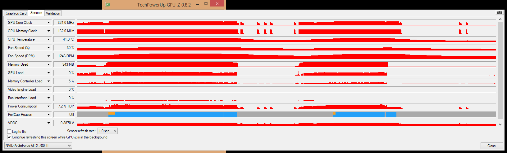

This is the GPU-Z readout for two short sessions of Cities Skylines: Linky. VRel is the main limiting factor, and sometimes VOp as well.
This isnt related to the PSU,this just how the card manages Boost,it only clocks up properly when it needs too(GPUusage increases)
Your PSU is working fine,the odds are the fan is just dodgy and its more noticabile now as it ramps up more due to higher overall system Power consumption/draw
