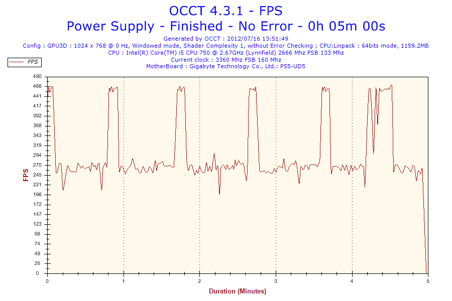

Low gpu usage = noticeable frame rate drops
Something wrong here somewhere ... i've locked the CPU @ 3.7, GPU @ Default and look at these FPS dips. It literally crawls to 0% GPU usage.

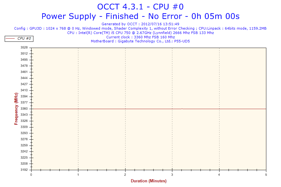

CPU
CPU Vcore (Again dips towards the end) - I've tried locking this to default voltage but still seems to fluctuate.
@ ljt - I see you're using the same motherboard, I wonder if this is CPU vcore related in someway. Does your CPU Vcore graph look similar to mine or is it constant? Maybe we need to look at a way of forcing the vcore to be constant, as mine is clearly fluctuating (They do seem to coincide with the FPS drops - look at the curve!!)
The cpu vcore drop is due to load increasing, which matches the fps dropping as it should. Different LLC values will affect the change.

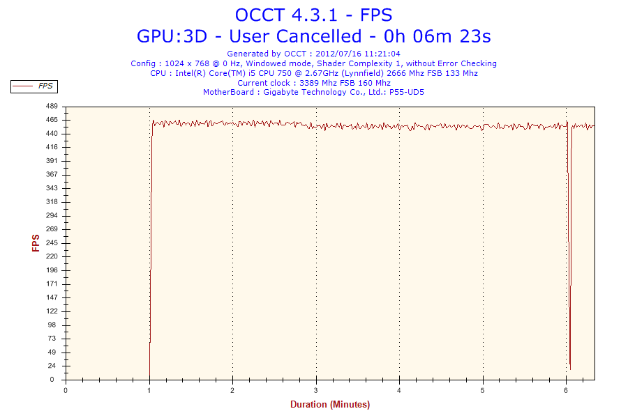

Just done that, GPU was locked @ 700mhz, FPS graph:
The Furmark element virtually grinds to a halt, literally REAL bad stutter. Im experiencing similar in game, just not as drastic.
