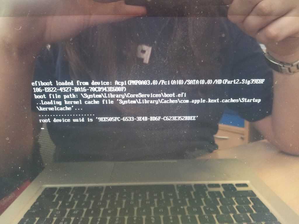

CMD + R doesn't do anything, it doesn't want to boot off of the USB recovery disk either :(
CMD + V gets this:
Its a 13" Late or Mid 2010 (can't remember which!), I've done the SMC as well. Guess I can try it again?
