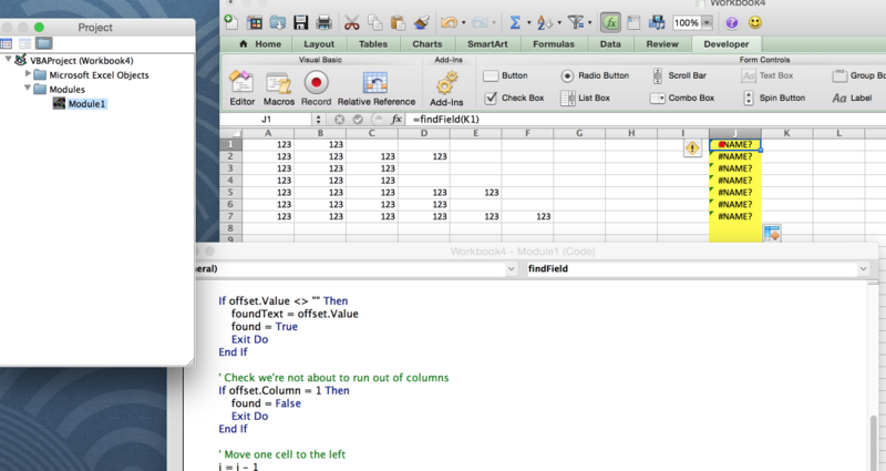

Thanks for that - excuse my n00bness but I'm struggling to get it to work.
Getting this error when I paste the code in - probably just me being an idiot.
Is there a way that I can highlight the column required or set it as j:j? Sorry about the questions - my excel skills max out at making unuseful graphs :(

You need to type the =findField() into the actual cell that you want your post code in like you would a regular formula (so delete that bit from the top of your VBA module).
So going off your screenshot, into J1 type =findField(K1) . This will look from K1 through to A1 and return the first cell that had a value into J1. You can then click the bottom right hand corner of that cell and drag it down to copy the formula to the other rows automatically.

Thanks again for the continued help - think I'm losing the will to live!
Got the formulas set in the cells - just trying to work out how to run the code.
25 Oct 2002
2,641
Sorry that's my mistake I misread your screenshot last night.
Change the K1 to I1 - it should be the cell directly to the left of the cell your typing findField into and K is on the right of J.
