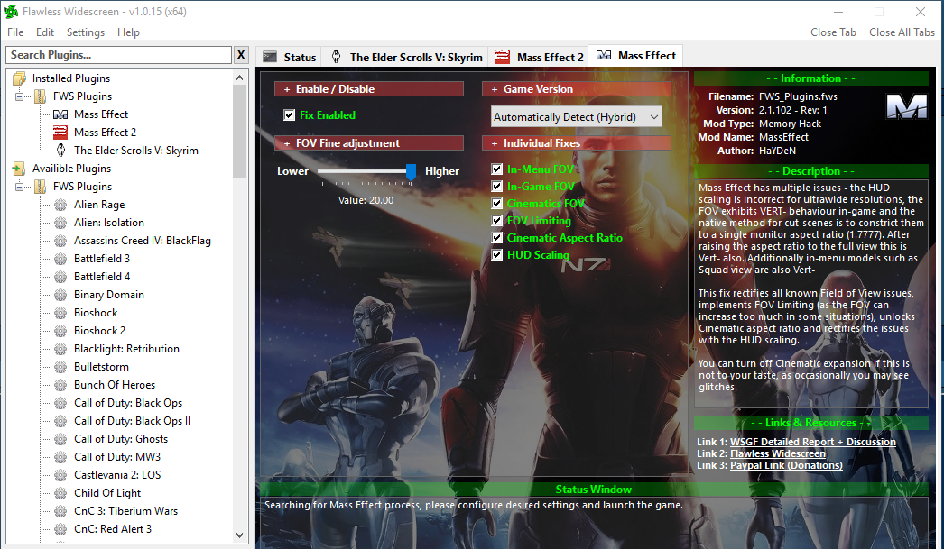

Thanks for this guys. How to I actually apply it to the game? I've downloaded it and selected Mass Effect but is hasn't changed the appearance in the game. Am I missing something?
Where is says configure settings and launch game as in the above screenshot - is there somewhere in the Flawless Widescreen application to configure the settings or what?
Is there a way of launching the game directly from Flawless Widescreen?
Edit: Ok so I've started playing with the Display Detection configuration settings and I can see the changes I've made making a difference but can't get them set right - can anyone advise what the settings should be. The automatic display detection is picking it up correctly...
Arrrgh this is driving me nuts. So I've learned you need to press CTRL ALT Z to activate the fix but it's still not right. I've tried every combination of setting I can think of - I'm close but can't get the correct FOV along with the HUD and menus to display fully. HELLLP!
Got it! Good old google and some experimentation prevails in the end. For anyone else trying this, here is as close as I could get to perfect in the Display Setting configuration I manually entered:
Width: 3440 Height: 1440 HUD Width: 1920 (HUD will get cut off if any wider) HUD Height: 1440 HUD X: 328 HUD Y: 1440

Just has my first combat encounter using this and ugh! No, the targeting reticle is off by about 3 inches! I can't see how I could get used to that. I thought is was just for talking to NPCs and interacting with stuff. I'd rather have the black borders in 16:9. Does anyone know how to get this running at 2560x1440?
Or does anyone know how to stop the 1920x1080 resolution stretching to fill my full 21:9 panel? I've tried all the display options in driver settings profile options but no joy.
If you have managed this without the issues with the out of combat targeting reticle let me know.
Hey managed to sort the combat targeting reticle! Change HUD X to 750. This makes it pretty spot on although it doesn't fix the marker for interacting with NPCs/items but makes it playable now for me. :)

I managed to maintain 21:9 resolution and remove the NPC/item targeting issue whilst maintaining the correct targeting reticle for your gun (anyone with 21:9 and the FW fix will know about this problem).
1)Use FW as usual with the presets mentioned earlier in this thread.
2)Go into \Documents\BioWare\Mass Effect\ConfigBIOGuiResources.ini
3)Make the following edit and save
4)[BIOC_Base.BioSFHandler_Reticule]
m_fMinScalingRange=1000.0f
m_fMinScalingValue=0.2f
to
m_fMinScalingRange=0.0f
m_fMinScalingValue=0.0f
Works for me, hope it does for anyone else interested as well.
