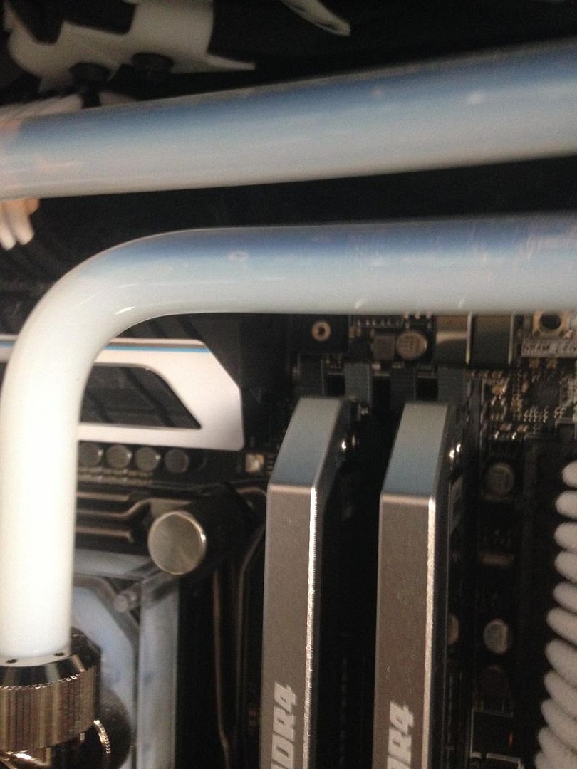

Hi I'd like the mayhems rep an you guys to have a look at this, I've left my system off for about 3 days, I'm using mayhems pastel ice white in it and I've notice it's turned slightly blue in the acyrlic tubing an reserviors??
I flushed my system out with distiller water 5 times before adding the mayhems here's some pics any help
Would be appreciated!!
[/URL][/IMG]
I use the same stuff and it is slightly on the blue side of white, especially when it isn't at the correct concentration.
My system had been off for a week now so I will check how it looks when I get home.
Turn your system on though and it should mix together again.
After being off for a week my mayhems has done exactly the same.
I turned the system back on and it got mixed up again.
