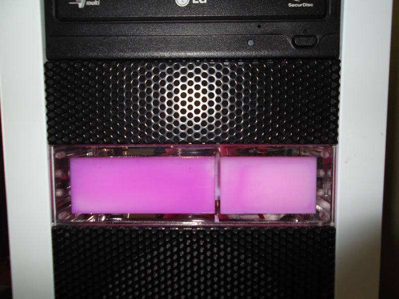

Ive had a full litre in my system now since mid april and now the liquid in the res has started going white (its not the res as when I tilt the case, its clear). My system doesnt get overly hot (sits at about 35 most of the time, never goes over 60).

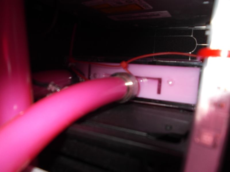

The tubing was clear and from the last time I checked (last week), the discolouration was only in the res.
Pictures
What it should look like
I couldnt decide which shown the white better
Contrast of what it should be (tubing) to what it is (res)
Interesting.. my first thought is that the pastel has lost its colour because the dye has stuck to your tubing (which is why it still appears the normal colour in the tubes but not the res)
Thats what Im thinking now, guess Ill have to wait until pay day to get more fluid and possibly tubing.
