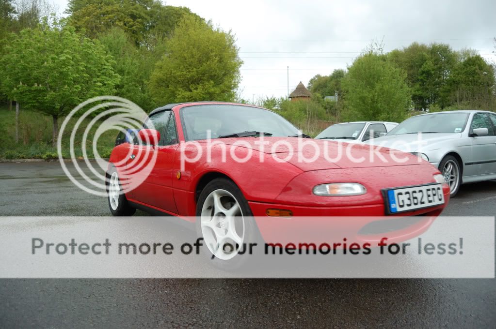

Talking of wheels I thought Howards at RR10 looked quite smart;
