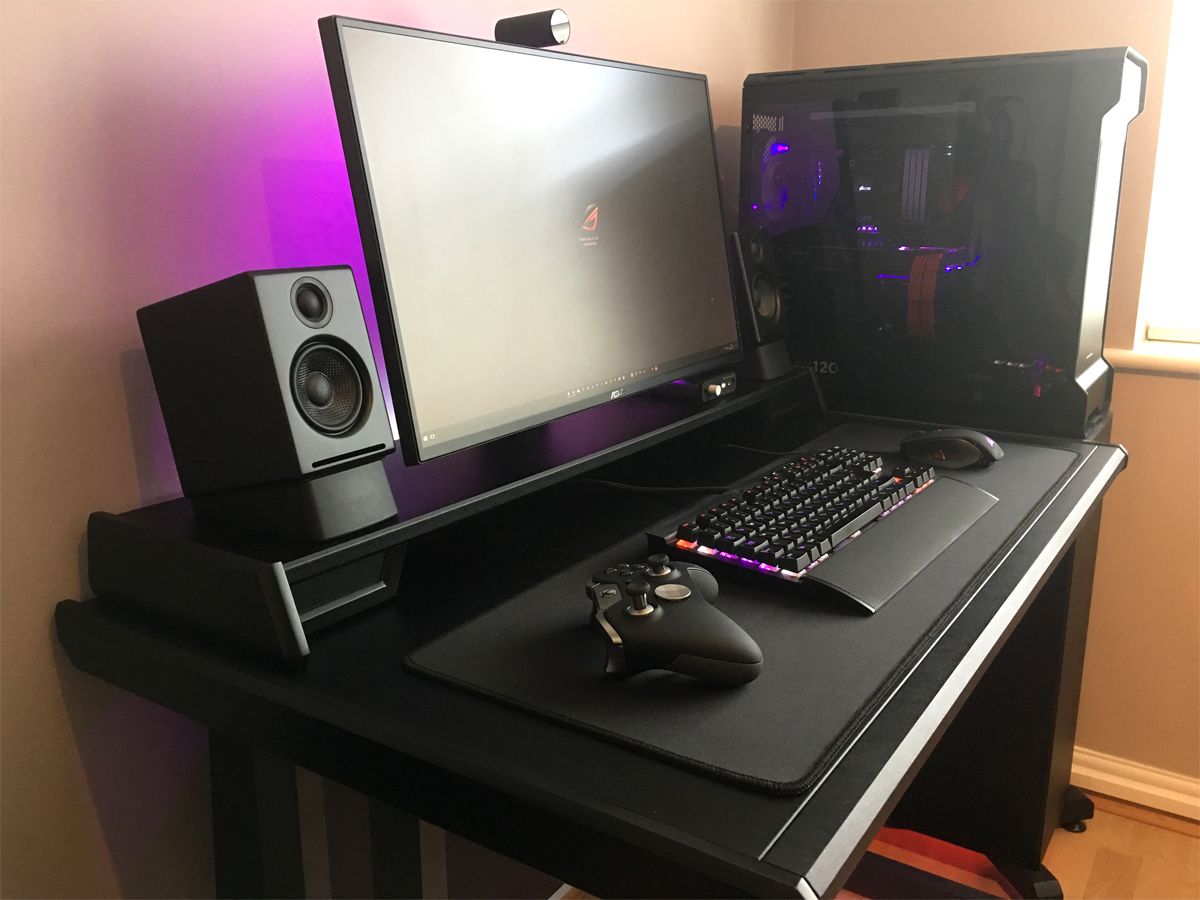

I use MDF for a lot of my projects. Samples:
You can have a good look through my thread here which has some info on finishing.
https://www.avforums.com/threads/thereis0nly0nes-diy-project-builds-thread.1958872/
There's also a build log, here, which has lots of pictures on MDF finishing:
http://www.isrtv.com/forums/topic/12145-r-pod-mkii-vr-enabled/
There is more than one way to skin the proverbial but I find this is a consistent way to get decent results.
NB Blackboard vinyl is a great way to cheat and obtain a great finish on flat surfaces (ok, it's not white ...)
Also consider t-molding for edges. P38 car boy filler is what I use for the rough edges - works a treat but expect to expend some effort to get a good finish
Hope that helps.

How durable is that as a finish?
I'm wondering if it would be suitable for use on an arcade cabinet that would be used by children?
It's pretty durable. I covered my desk with it and it's been good for more than 4 years.
I also have it on my arcade cabinet control panel (and other areas of the cab), albeit with cast acrylic for the main section.
That does look good!! Methinks I may investigate this then. where do you normally get it from and how easy is it to work with?
I usually get it from here:
http://www.mdpsupplies.co.uk/blackboard.asp
It's quite easy to work with. Sometimes an extra pair of hands helps when applying it to large surfaces. The surface must obviously be free of any debris otherwise it's like the princess and the pea if you know what I mean. If working around 2 planes and the angle is greater than about 60 degrees, it's best to round off the edge very slightly to avoid bubbling. It can save a massive amount of time on project builds and has a great texture to it.

I do have metal stickers applied to another project build (PC display stand) which seem ok:
