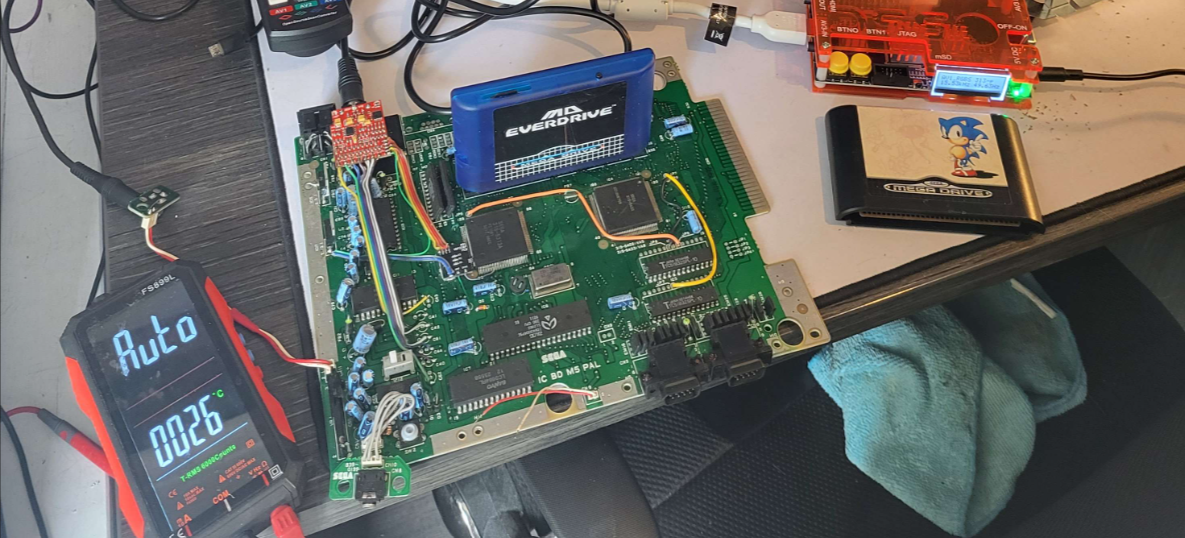

The 3bp mod also known as a tripple bypass bypasses audio and video final stage processing and throws them through a mod board effectively allowing for cleaner video and dialling in of your audio preferences:

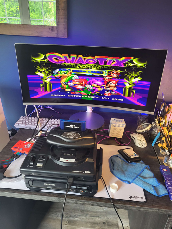

This is about the best quick image I could find of mine. It replaces the big megadrive composite DIN for a RGB din connection the same as the MD2 and generally gives a much nicer picture which my photography skills will never do justice to :cry: :
Probably a bit niche for most but its a solid upgrade to the MD1... I have a feeling there is one you can buy now with an upscaler built in (will have to check that).
