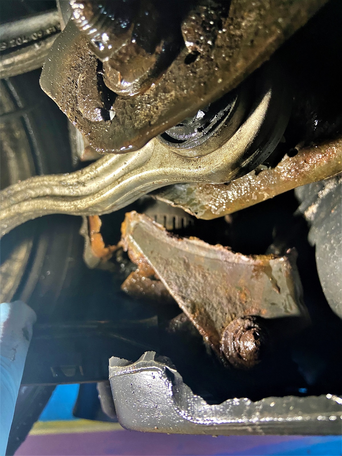

What he's failed it for "Suspension component mounting prescribed area excessively corroded significantly reducing structural strength Nearside Rear (forward arm mount on subframe) [5.3.6 (a) (i) ]" would usually be a fail for within 30cm of mounting points ie where suspension components mount to the body of the car and not the subframe itself.
This would be for the subframe..
If the subframe has corroded and holed, then Merc will replace it under warranty (I've failed loads of them when I worked for Mercedes and also where I work now).
This is one from a few months ago..
The rear arm completely detatches itself from the subframe, giving interesting handling characteristics :eek:

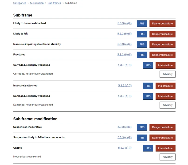

From my reading of it I could continue to drive it until the current certificate runs out on the 11th January, of course I could have totally misread it....
No, while it does technically have a valid MOT, it also has a dangerous fault, which means it's not legal to drive (section 40a of the road traffic act).
It's failed on a 'major' item though, not sure that's allowed to be driven anywhere other than to a repair place.
The report doesn't say it's dangerous "only" that it's major and needs immediate repair. I wish it were clearer although I don't want to drive it except to the dealership.
It's simple enough, major failure allows you to drive to a place or repair or for a retest, a dangerous failure means no driving it on the road under any circumstances.
