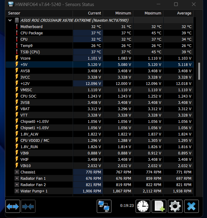

I took some hardware info readings of my system when i started up a game to see what my system was doing
Something to note i think my 5v rail is a bit high but other than that everything looks ok?
You can hit record I think (+ button), but even if it shows a drop on one of the rails, that's not necessarily informative.
