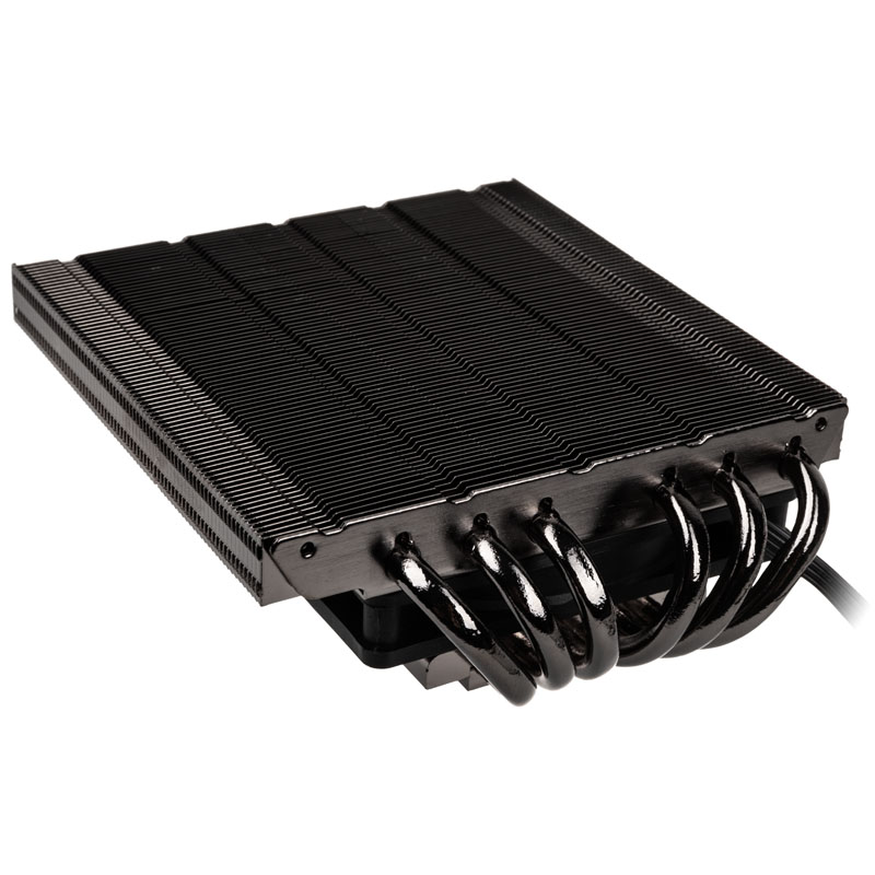

That case can be a GPU oven, I remember a while ago most recommended you get a blower GPU (so it exhausts the heat straight out the case) and a decent low profile CPU cooler.
Still no idea about your single power cable requirement... But PC wise if you want to use the Node 202, with the above in mind, I'd go for something like this.
As you said money wasn't a problem, the only things you may want to change is the NVMe if you want a larger 2TB which would add approx £160. Or if you wanted 32GB RAM would add £100 for the 2x 16GB kit.
