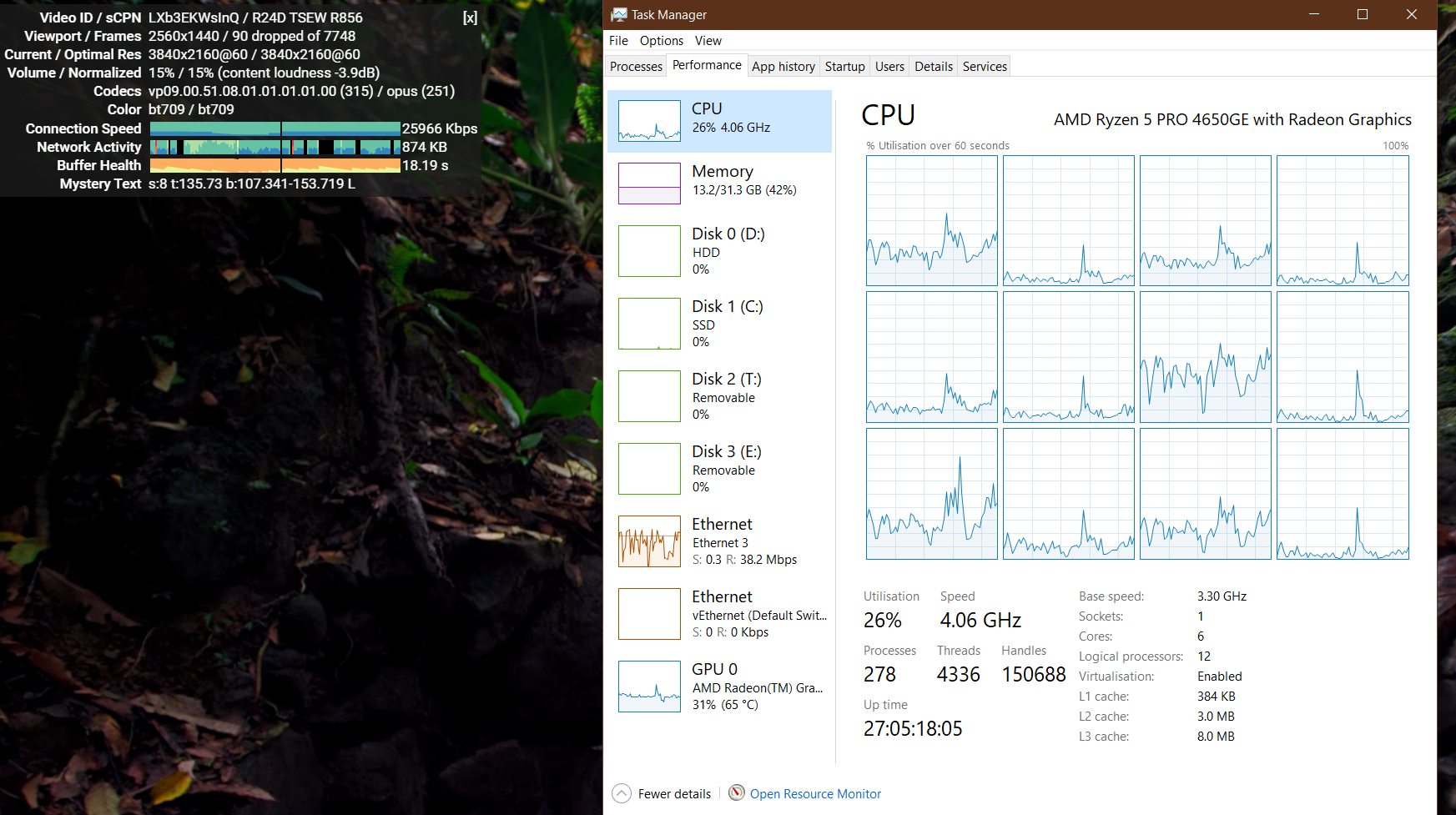

Not sure if this helps, but my work machine HP Elitedesk 805 G6 Mini copes fine with a 4K video streaming on one screen and web browsing on the other:
https://support.hp.com/gb-en/document/c06955644
The machine shipped as standard with a 65W PSU, but I found the CPU to be throttling on occasions (due to the extra hard drive installed and numerous USB devices), so swapped it out for a 90W PSU.
Video is
(Shows as VP9 - not sure how to test an AV1?)
thanks, yeah very nice system that power psu issue and cpu throttling is a known drawback to having sff or mini type pcs, sometimes even enabling another 4K screen or usb device or hdd like you say causes it to hit a bump in the road, its probably something ill have to really just test and see for a few weeks.
VP9 I believe is the older YT codecs, they still use it in many videos and I think when AV1 is not available or been converted too, so it still does much of the
decoding off the gpu at least, your usage numbers look good actually 31% for the gpu is decent I hit 44% currently with the Costa Rica in 4K 60fps hdr on
my 4K tv and 10 browser windows open but have 6-9% cpu load. Power varies quite a fair bit anyhow.
