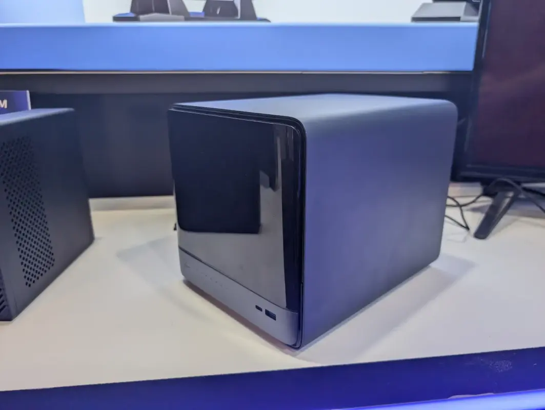

This upcoming NAS looks pretty decent for those not wanting to use turnkey solutions such as Synology and QNAP.
AMD 12 core/24 threads, up to 96GB ECC DDR5 RAM, 5 bays, 2x SSD slots, 10 GbE/5GbE, PCI expansion, NVMe support etc.
Specs copied from the nascompares article.

This box looks ideal for TrueNAS as an example, Unraid or even as a hypervisor. I hope the Plex can make use of transcoding but it can be a bit hit and miss with AMD. TrueNAS historically has played much better with Intel CPUs also.
I'll be keeping an eye on this. I also hope they could come up with a short depth rack mount solution.
With that solid front I can see the HDDs getting very hot. Just like on my N1 until I removed the front plate.
I saw a video which touched on the N5 and what struck me was that the bottom tray with the motherboard slides out which makes maintenance and upgrades very easy so I can see this being favoured by corporates with lots of sites and also exhibitors.
Will be interesting how this compares to a DIY build cost wise.
