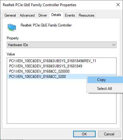

In my device manager i have under other devices,PCI encryption/decryption controller. Which has a question mark next to it ( there are no drivers installed) Does anybody know what this is? It is on a fresh zen 2/ x570 build with all drivers and software up to date.
right click the one with the question mark > Properties > Details > Hardware ID > Copy the ID into Google and should tell you what hardware it is. For example...
