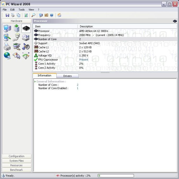

In his picture he posted it says X2 so ye he has one. I think maybe you have a faulty cpu. You could try another bios but that reinstall should have fixed it already..

Firstly It has shown two graphs in task manager for nearly 2 years so I am positive it's a dual core.
I have done a completely fresh install of, firstly Vista - no joy, then XP Pro. It was still recognised as a single core. I have cleared the CMOS - still one core, installed the latest BIOS, installed the processor hotfix/driver etc. Basically tried every suggestion I have been offered on the net.
I'm starting to resign myself to the fact that there may be something wrong with the processor. :(
